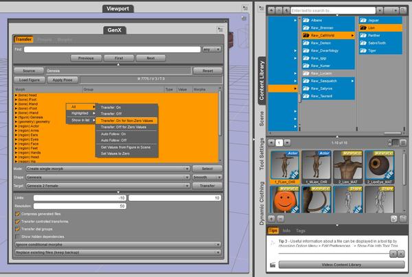

    Have you loaded the Genesis figure from the Source button first? If Genesis isn't already loaded, then it can't transfer.
    Once Genesis is loaded, I use the Actor file for the male lion to map to G2M, the one called 1_MLion_CHR for male or 1_FLion_CHR for the female. The only indication that anything is happening at that point will be that the number of morphs available for transfer will change -- the little tiny numbers at the top of the inside part of the pane. Then right-click on something inside the pane, select the "All" option, then "Transfer: On for Non Zero Values".
    At the bottom of the pane, you should have the following options, depending on whether you're transferring to G2M or G2F (see the image below). Those should allow you to transfer the Lion to Genesis 2.

  • vwranglervwrangler Posts: 5,045
    edited December 2014
    As a matter of purest curiosity, when you say, "It won't add to the list" ... what won't add to what list where? What exactly are you expecting to see?
    That aside, there's not much else to do.
    The only other thing I can suggest is to do it directly, without the presets. Once installed, the lion is part of the Genesis morphs, so it should be in there with the morph value set to 0.
    For the Female lion to transfer to G2F, search for "flion" (Under "Female/SciFi" in the ACTOR group - search in the white space next to "Find" in the GenX pane, with the dropdown set to "any" so that it doesn't try to search for complete words or phrases.)
    For the Male lion to transfer to G2M, search for "mlion". (Under "Male/SciFi" in the ACTOR group)
    Double click on the 0 in the Value column and change that to 1. That gives a non-zero value for GenX to see.
    You also want to search for
    - "RawCW_CatLegs" in the "Universal/Fantasy-SciFi" group, and change that value to 1
    - "Enable auto correction", in the "MorphKits/Corrected V4 UV" group, and change that value to 1 (for both male and female, for some reason)
    Follow the steps mentioned in my earlier post to select All > Transfer: On for Non-Zero Values
    If you transfer that to the appropriate figure, you should have the starting point. It probably won't transfer any dependencies, like the Freak shape for the male lion, but it will transfer the main shape. Then you can dial in the appropriate additional shapes from the Parameters or Shaping tabs of G2F or G2M.
    If that doesn't work. you'll need to bring up your issue in the GenX thread, where the plugin creator answers questions.
