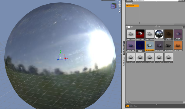

I'm trying to learn about Uberenvrioment.
I loaded one..I selected "Set HDR KHPark".
There's nothing else in the scene.
I render, it's a blank window.
I zoom out so I can see the Uberenvrioment sphere...I see the sphere with a park image on it (screen shot) I render...nothing.
I clearly completely misunderstand what is going on here.
Shouldn't that park be a background or something?
1958 x 1157 - 990K
  • prixatprixat Posts: 1,627
    The HDR files are for lighting and like most lights in 3D you don't normally want to see the light source.
    The sphere that the HDR is mapped to is set as 'non-rendering, visible only in preview but still light emitting' by default.
    To see the lighting effect you have to have some objects in the scene to get lit and make shadows etc.
    HDRs are different to other lights as they contain a 360 environment, to see that you select the sphere and in the parameters tab you can change it to 'visible in render'
