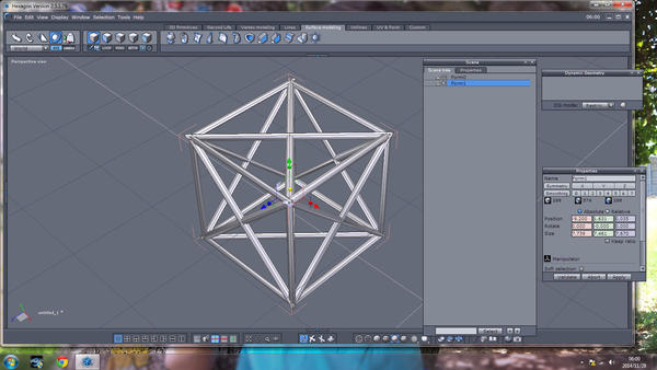

As much as I know about hexagon, I still have trouble making lines that are closed and connect properly. Let's say for example I want to make some structural bars from the lines of a model. When I copy the lines, I get multiple curves rather than one solid curve. With some models you can make them all one curve, but with most you cannot no matter how much welding or connecting you do. Then when I add thickness to the lines, there is almost always some overlapping or clipping through each other at points.
Anyone have any tips to get around this without having to painstakingly model structural things from faces?

    Note: I know I can do it as pictured below, with face splitting and extrusions, deleting faces then adding thickness, but many shapes are either impossible to do this way or too tedious, which is why I'm looking for a way to do it directly from lines, especially so I can do rounded bars connected to each other rather than boxy ones.

  • RoygeeRoygee Posts: 2,247
    Interesting problem :) I would imagine that to get what you wanted done, you would have to have a continuous polyline - something like those puzzles where you have to draw a shape without lifting the pencil from the paper. I'd say pretty much impossible :)
    The problem in Hex is that you can't make a composite curve where a closed curve is involved. Normally, you can weld curves if the points share a common space, but not when one of them is a closed curve.
    About the closest I could get was to make a square using a polyline and give it thickness - that way you at least get the corners decent. Keep copying and rotating to get four sides then delete overlapping faces. Drew a transverse polyline on one of the sides, gave it thickness, copied and rotated the copy to get an X. Did a Boolean union, then copied that to all sides, welded the lot.
    Not at all satisfactory - would need a lot of work to get it looking decent.
    Interesting to see what solutions others come up with :)

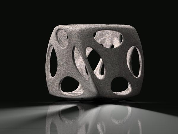

  • m_m_italym_m_italy Posts: 395
    :long:
    Usare facce...
    Cancellare facce...
    1148 x 841 - 71K
  • Cris PalominoCris Palomino Posts: 13,041
    Looks like you have subdivision on it.
    edited November 2014
    I worked with the faces.
    The problem exists when using lines.
    he's right user.operator and Roy. (user.operator e Roy hanno ragione)
    Bye
    800 x 600 - 203K
