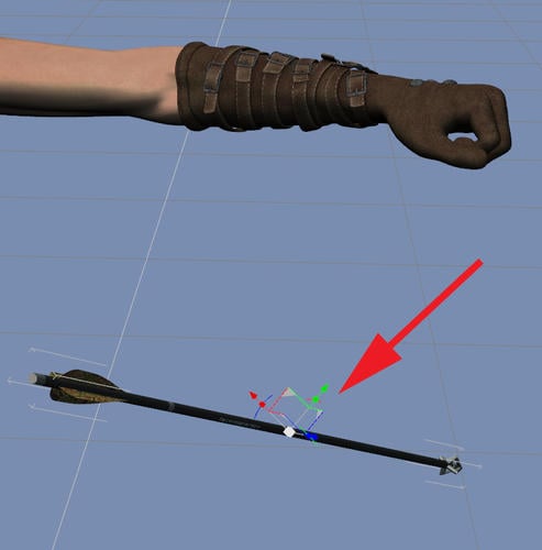

    I too have struggled with this one. Here is what I do, but there are likely better ways. Please excuse me if this is how you do it.
    Mostly I work with the Universal tool. First set up the hand to a pose that makes sense for your prop. Now select the Universal tool. In the first image it is the second icon from the left. Select the prop. The example image is a G2 ranger and arrow. I want to move the arrow into the left hand.
    Use the Move/rotate frame to position the prop in relation to the hand. I don't know its actual name. It is the Red-Green-Blue frame that you see typically at the center of the prop. Dragging the red, green, or blue arrowheads will drag the prop in that direction only. Dragging one of the three circles near the arrowheads rotates in that direction only. Dragging the colored cubes allows you to scale in that direction. Dragging the center white cube will scale the whole object uniformly. This is a very well designed piece of GUI.
    You will have to rotate your perspective in order to see which direction to move and rotate. It will take a few iterations to get all three axes and rotations just right. I generally translate the object to the hand, then rotate into position. Finally tweaking the translation to get it just right.
    Once in position, don't forget to parent the prop to the correct hand. Used to be really annoying when I forgot to do that. But now with crtl-Z as an undo you can recover quickly.
    As you suggest, you could write down the coordinates of the hands for your figure and then type them in to your prop. You would still have to tweak in all six axes. I just find the move-rotate frame super easy.
    Hope that helps.

  • jstiltonjstilton Posts: 134
    thanks for this. i normally don't use those pointers on the objects (the red, green, yellow things) much because i find it hard to precisely select the right ones (always takes a couple of clicks), but i have found out that sometimes they work better than changing the dials of the translation axes.
    still, it remains all quite cumbersome i think. most of the time i need to turn my whole image to see if the position of my object is exactly right. if there would a function like "move this object to this position" (the way parenting works, but it would just move them in space without sticking them)
