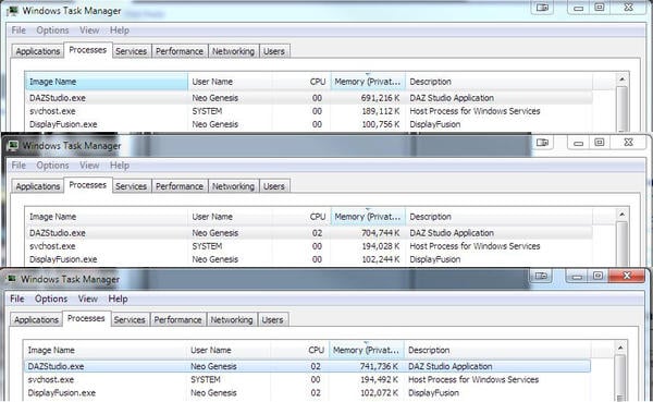

This is getting to be insane. Please tell me this is fixable cause 1 genesis on base res should not be consuming 65% of my ram.

    However... it does seem that your Daz Studio is a bit excessive on the memory hogging. I opened up a new document and placed Genesis in the scene. The following was my memory usage. The second listing shows Genesis loaded with a basic texture, in this case Nyu for Aiko 5.
    I tried again, using Genesis 2 with Belle 6, and the result was still a lot smaller (3rd listing). These are empty scenes with just the figure loaded and nothing else. Are you using anything alongside your figures, and which version are you running? Had you been running Daz Studio for a while? Daz keeps a cache of previously loaded content so it can quickly load it back in, not to mention things like your Undo/Redo history and so on.

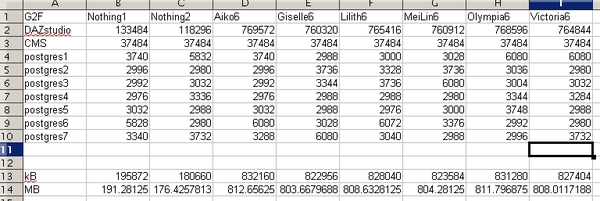

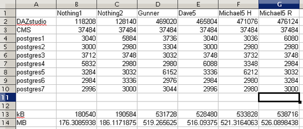

    Havos, I will concur with that, having just tried a rem test. Start daz, load a figure, screen-cap the ram use. Close Daz Studio to free things up, and repeat for the rest of the gen 5 figures I have.
    This is just for the figure, and is some what utterly useless as it dose not include Hair or cloths. Not even the "Critical bits" that are another add on (prosthetic) for the figure, lol.
    This is for just the single figure, and dose not consider what happens with additional figures sharing morphs and stuff in ram. In fact the morph add-on kits you have do in fact make a dent in the ram usage, everything dose.
    H = Heroic, and R = Regular.
    (EDIT)
    And here is the G2F lineup that I have, none of are HD as base. A considerable variation in Daz Studio alone that I don't know the reasons for, same with the CMS database engine. "O" I do have a considerable collection of G2F face and body morph kits beyond the two basic required by many.
