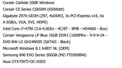

    i put that one in my request. this would be the config. what do you think? :-)
    costs about 1500$ here by the way
    (the card you suggested is actually cheaper than the nvidia quadro. why is that?)
    thanks again!

  • prixatprixat Posts: 1,627
    Looks good, is that in US dollars?
  • jstiltonjstilton Posts: 134
    yes, US dollars
    things here in europe are more expensive than in the US
    nothing i can improve (without dramatically increasing cost)?
    I'm working in GBP £, I calculate that you're around £120 away from an i7-5820 system with the same specs.
    that's a faster processor? will it make much of a difference?
    You get 2 extra cores, 6 cores will make significant difference in rendering times.
    Its on the latest X99 motherboard which gives you a bit of future-proofing with new technologies like M.2 and DDR4.
    Depending on how much extra it costs where you live, I think its worth considering.
