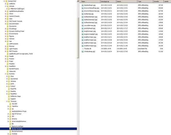

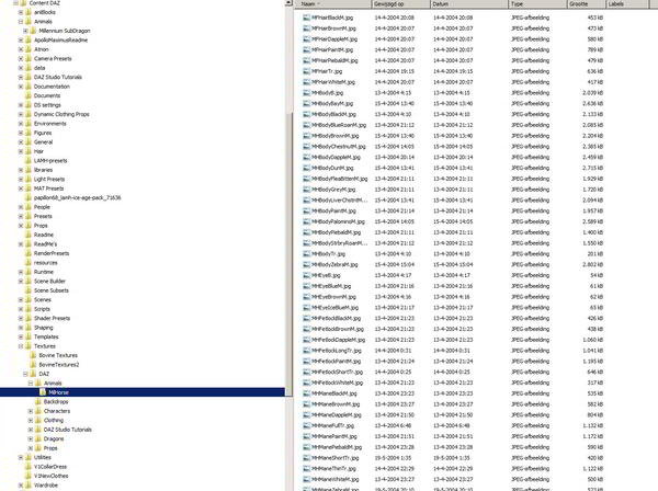

New to this forum, so bear with me. I've just purchased the millennium horse pack, installed offline using DIM, but the textures can't be found. The horse is there, but without manes or textures. In explorer I find the textures in a folder in E/contents DAZ/textures/daz/animals/millhorse, a database I created on another partition. Strangely other textures (for bovines, e.g.) are found in a folder 'textures' in the main runtime folder.
I am aware that it's complicated, and my database might be a mess because I've also copied content folders from 3rd parties into the hopefully right folders (same names). I've uninstalled the millhorse a few times, reinstalled, installed the separated packages as well through DIM, but to no avail.
I hope someone can help me sort this out. Thanks!

    I just checked my Mil Horse install through DIM, and all of the textures are installed into Runtime/Textures/DAZ/Animals. In fact, everything for the Mil Horse is installed into the Runtime folder, since it is all in Poser Format.
    If you installed using DIM, you can select the Mil Horse in the Installed tab, right click, and then select 'Show Installed Files', that will tell you what library folder it has been installed to (at the top), and the path to every file that has been installed. These are all clickable links.
    Make sure that the library that DIM is installing to is listed as both DAZ Studio 'AND' Poser Formats in Edit > Preferences > Content Library > Content Directory Manager.

    For the basic Millennium Horse, the material presets will be in "Content Library > Poser Formats > [your content folder] > Pose > MAT Mil Horse”

    You do not load these using the OBJ file, you would use the CR2 (Poser format) file from the Content Library pane.
    Go to Content Library > Poser Formats > My DAZ 3D Library > Figures, and you will find the CR2 files in there. Look at my first post, it tells you how to find out where they were installed to, and how to make sure that DS knows the path to the files.
