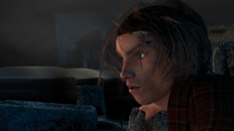

My renders are showing THROUGH my (model's) hair, making it look like one of those little old ladies who barely has hair left but gets it styled anyway (men just shave it).

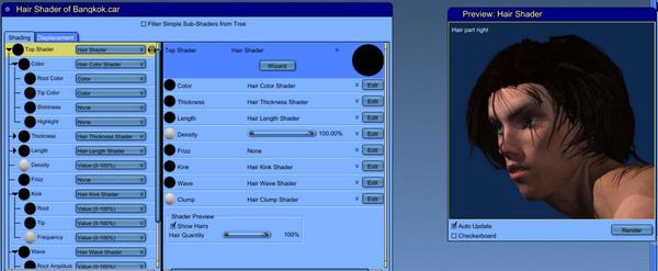

In an effort to figure out this transparent hair issue, I made the root and tip completely black. I also removed Shininess and Highlight.
I have 45000 hairs, 8 segments, medium thickness, scale of 2.0.

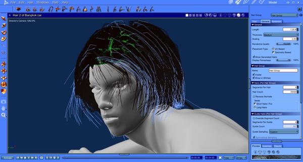

    Hide all generated hairs and then look at your guides... are some too close to the scalp? If so the hair is inside your model. Looking at the lower image, are you using clumping? That feature seems to have a mind of its own so I try to avoid it. Usually I use PUSH to get every guide hair off the scalp and start from there which is how I find guides that are not positioned how I want them.

    It may also help to give the Shininess and Highlight channels some values to catch some of the light. Instead of "None" try something like:
    Shininess = Value 1-100 = "20"
    Highlight = Value 1-100 = "10"
    for starters.
    "10" is fairly low for highlight, for subtlety, but could go much lower, like 1, 2, 5, etc., which are really low grey scale.
    Keeping that in mind, you can then tweak some color into that. Realizing how incredibly close to black you are, throw in a color chip and bring it super close to black, and then just as much toward the color (saturation) edge as you want color to bleed in.
    I could be on the wrong track here, but highlight/shininess has a lot to do with how our objects deal with light.
    Shininess
    The lower the value, the more the Highlight channel will flow through (or across) the surface. In this case, the whole strand. So a value of "0" will allow the highlight channel to affect the entire strand of hair. Higher numbers can get so 'tight' (light angle) that it's just like using "None", having virtually no visible effect. I never use values above 50, but very seldom go over 33 for shininess. 33 is even way too high for most of my needs. If I want to make an object look really glossy, a shininess value of 16 to 24 will often look super glossy enough for me, but I render at lower settings for speed.
    Anyways, I would recommend not going too high on shininess unless you really want glossy individual strands - and maybe that might give a better look. These two channels seem to behave a bit differently on hair than they do actual geometry. So play around a bit.

    Looking again at your lower image of the hair room with guide hairs and generated hairs... I think I am definitely seeing your hair bending inward and going inside the forehead then coming out of the eyelid. The guides may look OK, but the other attributes take over.
    Perhaps let up on the kink/wave and clumping which direct hair in ways that I find hard to control myself. If the hair pops out of the forehead and falls over his eyes, then you will know if that is it for sure. Just a suggestion to try.
    I think your hair is poking inside your model. Your render isn't poking through the hair, it's the other way around!

    ...and the answer IS!
    Light cones. I had a light set up with a light cone in the background and it was the culprit.
    Thanks all!
    480 x 270 - 11K
  • murph101murph101 Posts: 68
    quick correction... it was the lens flare that was the culprit.
    correction yet again... the light cone WILL cause the see-through-hair if the cone is angled at the hair subject, or appears behind the hair at all.
