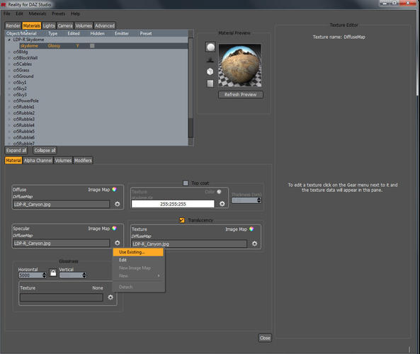

    It seems light emission was where I was having most problems... Turning that off helped a great deal (although, I could imagine some instances where I'd want that activated). Now I'm getting somewhere with getting the rich blackness and starlight of atmospheric sets like Flipmode's Solar System to show up with Reality. Hopefully, FM's Night Builder and Dreamlight's Rendersphere can now be used.
    This has saved me a lot of money in getting new skydome equivalents! Seems like your advice finally makes them compatible with the product. :) Now I can use these techniques for skydomes and Bryce to create my own skies, I can finally take advantage of Reality's amazing artistic potential.
    And a big thanks to those who explained what Bryce Lightning is.
    All I can say is... experiment, experiment, experiment.
    My biggest Reality headache was getting the textures over, but that hasn't been an issue for a while now. It takes some "unlearning" since Lux works more like real light; a lot of the lighting and shader tricks are not necessary.

    The same process should work with any skydome. I only defaulted to Dreamlight's because it was the easiest to experiment with.
    If you'd like, I can take a stab with a different skydome. Maybe one that comes with an environment set?

    You may still be able to use the images from those skydomes. If they are laid out in a standard way you could apply them to an existing skydome model or use them as an IBL?

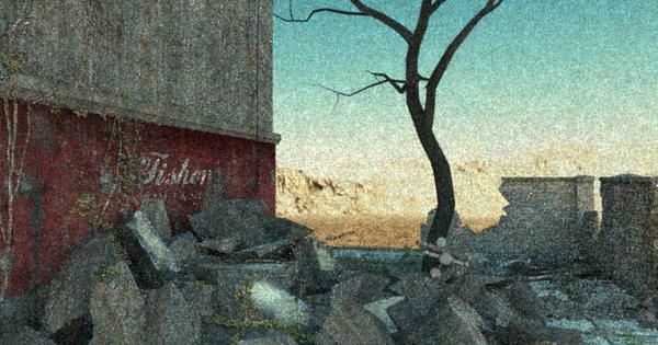

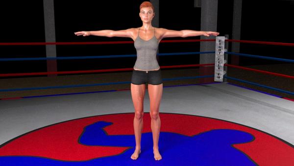

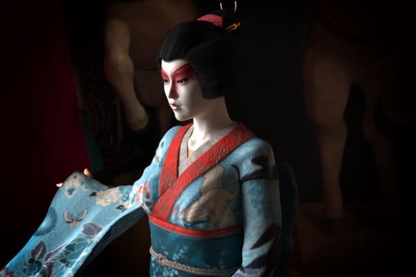

  • Jason GalterioJason Galterio Posts: 2,562
    edited December 2014
    One more (I promise this is my last)...
    Flipmode's Top of the World Easy Environment.
    One camera, one light source (Sun), Sky Box 1.
    This skybox took a little more tinkering because it isn't one texture.
    All the materials to the skybox were set to Matte. Translucency was turned on. The translucency texture was modified from the default to "Use Diffuse Map." Light emission (which defaults to On) was turned off.
    Inside Lux, both "sun" and "sky" were left at their default Gain of 1. Tone mapping is set at Contrast 8.6596, preserve luminosity. This wasn't a precise setting, just my nudging the slider along until I liked the results.
    Image was rendered for 30 minutes to 135 threads, 498% efficiency on a Dell laptop.
    To my eye, the skybox results are pretty close to the results I would expect in a native DS render. I did not modify the materials of the foreground, left them at the default that Reality came up with.

    Post edited by Jason Galterio on

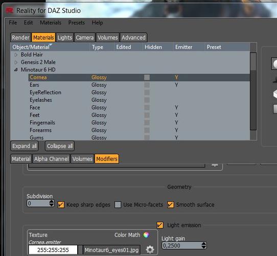

    According to a posting on the Reality Forum, some Reality 4 users are noticing a lot of materials set as light emitters when they should not be. This is probably because some vendors are in the habit of dialing in a little Ambient, perhaps 5-10%, to lighten up the item's textures in Studio or Poser. I generally just turn these to 0 in DS, but it is something to watch out for. You need to find all the surfaces Reality 4 sees as light emitters and decide whether they really are supposed to be light emitters or not. Just an FYI. Of course, if you WANT glow-in-the-dark people, be my guest. Anybody got a Chernobyl 3D model? :lol:
    Forgive my ignorance, but what is shdope? I don't recognize that one.
    I have a scene that I was planning to render tonight anyway. It might suit your purposes since I was intentionally working with the shadows to see how they would turn out. Forest Superior, Dreamlight skydome and one sun light source.
    Thanks for the heads up Slimer. I didn't think to check for more emitters, but I will be now.
    Those materials will show up in LuxRender as a Light Group, "LEM:whatever". You can just set them to zero when you are adjusting your lights, which will effectively turn them off. :)
    You can do that, but you would be wasting a lot of render time with lights that you don't need.

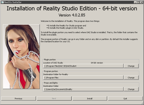

  • kyoto kidkyoto kid Posts: 42,399

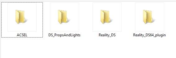

    ...OK extacted the .zip. to my desktop and it created a folder named "Reality_DS-w64".
    In that folder is the .exe along with several other items including a bunch of dll files and a folder titled "Assets" Where do these go?
    I thought maybe it would only have the .exe and possibly a readme. This is the type of stuff I do not understand.
  • Geminii23Geminii23 Posts: 1,328
    Tenmaru said:
    Kyoto Kid said:
    ...how will Daz 4.7 know which one to use?
    You are the one to command. Out of Render menu you choose either 'Reality Render' which is Reality 2.5 or 'Reality Render Editor' which is Reality 4.
    Ok, I am glad I am not the only one confused here.
    I have tried installing Reality 4 twice now. It doesn't ever show up in DAZ. Only Reality 2.5. Under Render Tab I do not get an additional Reality Render Editor. Just the basic Render Editor which doesn't load Reality 4.
    I also tried altering the Install path thinking it would overwrite 2.5 directory in the DAZ/Plugins folder. No luck. In comparing the folders, I did notice that 2.5 has Reality_2.0.dylib file. I do not see a corresponding file for 4.0 though.
    Can someone explain the process to install Reality 4 properly on a MAC with DAZ 4.7? If not to have both 2.5 and 4.0 co-exist I would be fine with knowing how to completely remove 2.5 and just have 4.0 working.
    Thanks.
  • Robert FreiseRobert Freise Posts: 4,700
    The exe is an installer run it and follow the prompts and it should put everything in place

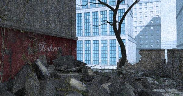

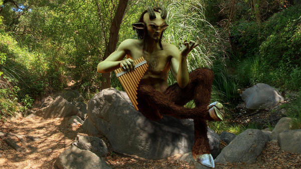

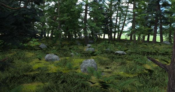

    Rendered over night. Forest Superior plus Dreamlight's LDR-P skydome and one Sun. I think this demonstrated the shadows fairly well. It's a little cluttered around ground, so the shadows might be a little harder to spot.
    No post processing done.
    1500 x 789 - 249K
