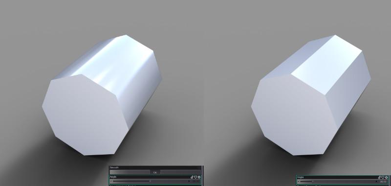

  • NewGuyNewGuy Posts: 330
    edited August 5
    I know this is a really old thread, but something else that people might still learn:  (I've seen it used incorrectly in some people's work)
    The OP tried to use the "angle" slider for the wrong reason, but the actual use of the angle channel, as the OP referenced, is to determine which angles of faces on geometry are smoothed.  Normally set to 89.90 degrees, the shader will smooth all angles that are less than that.  This can sometimes create unwanted smoothing on props where you'd like to actually see the edges.  The default works fine for organic surfaces, but not as much for props with hard edges.  I sometimes lower it to 50 or 30 degrees, depending on the surface.
    Below is an example of an octagonal prism with smooth shader set to default in the first image.  Notice the end cap edges are sharp, but the edges in the middle portion are blurred by the shader (because they are less than 89.90 degrees.  In the second example I've reduced the smooth angle to 30 degrees so that the edges appear sharp again and the faces are flat and can resolve light bouncing off of them as a flat surface.
    This is a common thing in programs like Blender when you Shade Auto Smooth (it allows you to set the minimum angle of smoothing).
    800 x 380 - 29K
