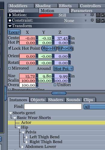

    edited May 2021
    trying to compare the general basic wear shorts to blended weight basic wear shorts,
    highlighting actor, motion and constrait are greyed out.
    after detaching the skeleon, motion on general says still, other says keyframed.
    dunno if that means anything for the skinning.
    it also unlocked the littl save icon.
    349 x 498 - 52K
    Post edited by Mistara on
