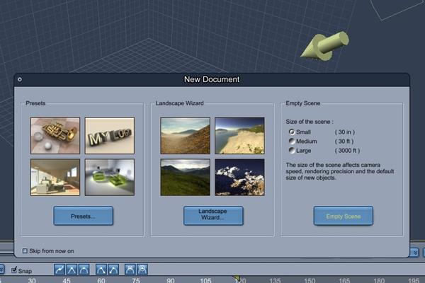

When I open a new scene there is a window asking what size scene I want to use. Say I chose the 30 inch size and begin. Then I realize later I should have chosen a larger size. Is there a way to change it once the scene has primitives in it?
1800 x 1200 - 252K
  • DartanbeckDartanbeck Posts: 22,154
    Yes.
    In the top row of the side panel on the right, it's the middle tab - Interface, I think it's called.
    Scroll to the very bottom of that upper tab to find Scene Magnitude and you shall find that which you seek ;)

    Thanks. I figured it had to be well hidden somewhere but I had no idea where. There are all kinds of things scattered around the window and I have no idea what most of them are. I know just enough to get to where I have to research or ask.
    Post edited by TimBo on
    It will change the scale of the scene, but you may still wan to change the grid size as that won't change. You can change it manually by going to View--> Grid. I window will open up, and if you started with a small scene the increments will be in inches. To change the grid to the medium size scene default, just delete the "in" and add "ft" to each field. Then click OK. Note that if you open the Grid menu again, the footage will be in inches again, but in the proper amount, so 30 ft would be 360 in.
    The Grid menu also comes in handy for customizing the gird dimensions. Say you want a long grid to help build a walk cycle, you could make it 50 ft or 100 ft on one side.
    A note regarding scene magnitude. If you make an object in a small scaled scene that is 3" and save it to the browser, then load it into a medium scaled scene, it will still be 3". It will just look smaller in relation to the grid size. This also works in reverse. You could be in a medium scaled scene and load in a terrain that is 10,000' X 10,000' and it will be that size.
