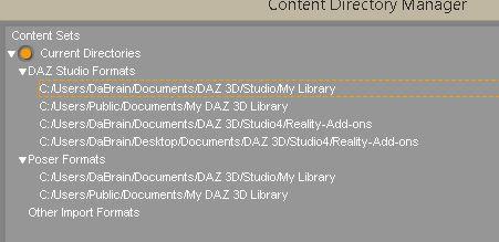

    I suspect you may have a problem with your content directory set up - please go to Edit>Preferences, go to the Content Library tab in the dialogue, and click the Content Directory Manager button; in that dialogue, expand all of the entries under Current Directories and post a screen shot of what you get here. Also please post the location to which you are saving your scenes.

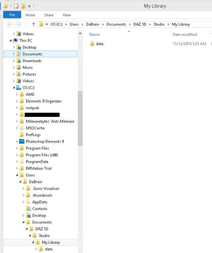

    Wow! I see what my problem is ... I think? They are not the same locations afterall... What is the preferred/easiest method of consolidating? ..
    Why did it choose now to start erroring out

  • Richard HaseltineRichard Haseltine Posts: 111,348
    Well, you can merge the Data folder in the Main User Account, and the \Runtime\Textures folder if there is one, with the other and that will cure the missing file errors. As long as the Data and textures are in one of the listed (mapped) directories, in the right sub-folder, scenes should load even if they aren't themselves in a content directory. But presumably you don't want to have those multiple folders - which account is the one you actually use, the MainUser one?

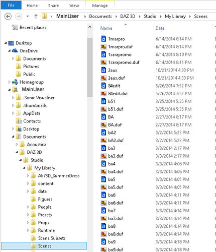

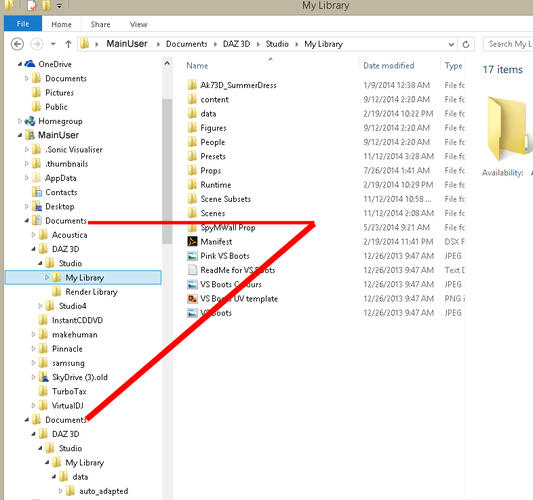

  • blue6stringblue6string Posts: 60
    Main user one is the one most used
    within the main user I found two document folders. It seems things are rather jumbled
    Try seelcting each Documents folder in turn, then click in the address bar (where the folder names are separate by triangles at the top of the window) - I think that should give you the literal path which may help to sort things out. Windows isn't giving the second Documents folder the special icon so it isn't treating it as "My Documents", but the Auto_Adapted folder shows that DS is using it.
