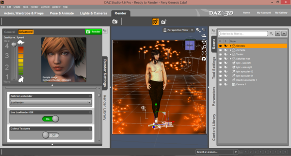

The LuxGUI is one of the first options in Render Settings, just below where you select Luxus and where you set the path to the actual LuxRenderer program.
Hi, thanks for the answer. It is activate. When I click In render button, DAZ shows the console. Then, one empty window of Luxrender appears. Its all, nothing happens.

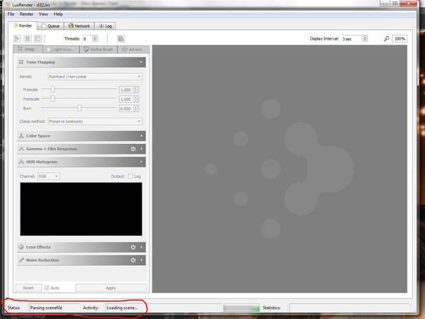

That's weird, I've never seen the render just fail to start before. In the message texts at the bottom, do you see "Status: Parsing scenefile" and "Activity: Loading scene" at all, even if only for a moment?

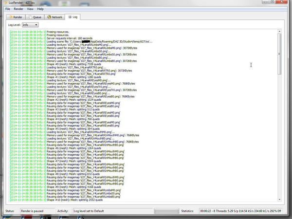

In the LuxGUI, click on the "Log" tab at the top and see if there's anything that looks relevant to a major failure. There should be a sequence of texture setups, followed by regular writing of the current render progress to the D|S temp folder.

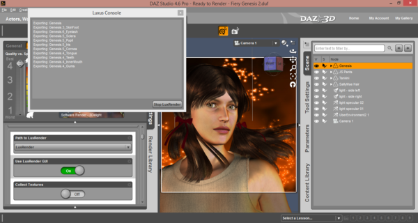

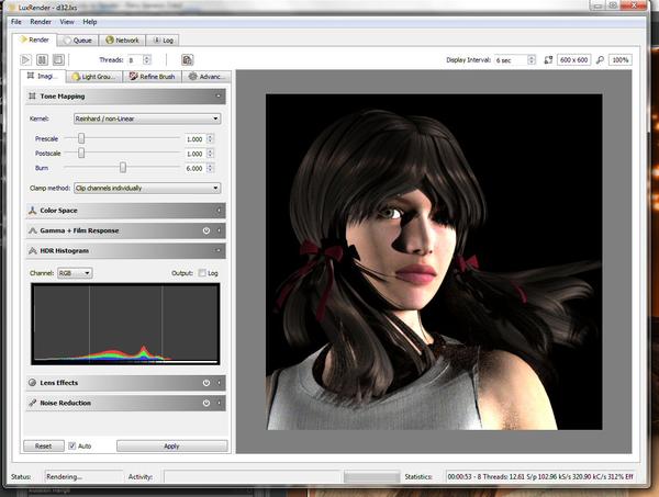

I don't have the latest version of LuxRender, but I tried the Firey Genesis 2 tutorial scene with LuxRender. It seemed to work fine. I brings up the LuxRender with 'Status:' saying "Parsing scenefile" and 'Activity:' being "Loading scene..." as shown in the first image. This takes about 15-20 seconds and then the render starts, as shown in the second image.
Are you getting the "Parsing scenefile" and "Loading scene..."?

What does the log panel of LuxRender show?

Luxrender log display:
“Status: Idle”
“Activity: Checkin log aknowledged”
“Log: Freeing resources.”
