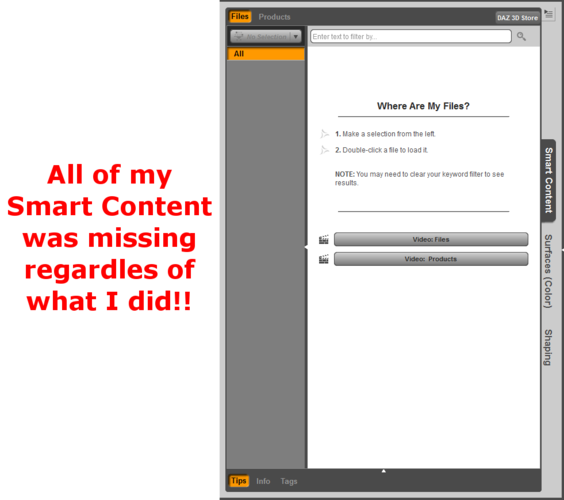

Today I was looking to test out an FBX animation file, so I started a new scene. I went into the Actors,Wardrobes & Props, and clicked on the Smart Content tab to load a copy of Genesis into the blank screen ... and my smart content was gone!
I know the files are all there somewhere, but DAZ Studio won't display any of the smart content in the Smart Content tab.
Worse yet, "Products" and "Categories" no longer work in the Content Library. I used to click on "Products" and get a series of alphabetized list of the different products installed. Now I get nothing. The search doesn't appear to work either.

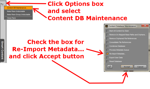

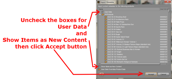

    If you don't have your own Categories set up, or your content organised in any way, then you have nothing to lose by going to the Content Library pane drop-down menu, select Content DB Maintenance, and in the menu that pops up, tick the box for 'Re-Import Metadata and see if that works.
    If that does not fix it, then you may have to use the Reset DataBase option, and try Re-Importing Metadata again.

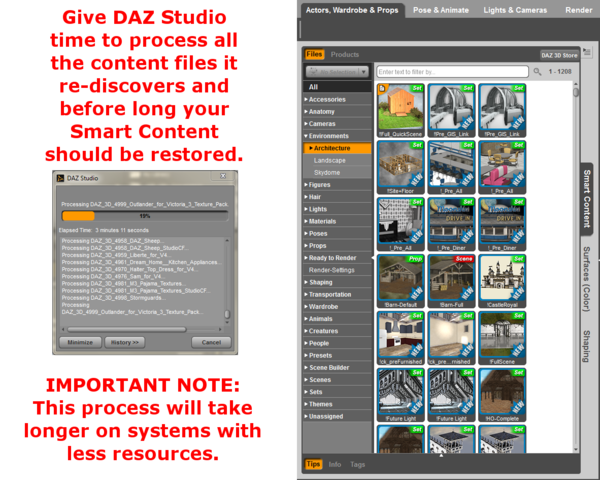

    Yay! That did it!

    I had the same problem after upgrading to DAZ Studio 4.6.3.52 several days ago. I tried to Reset Database but that didn't work. The corrective action was just what you guys said to do, thanks. For those who are less experienced, I have included step-by-step screenshots to help.
