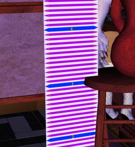

I've been working with a bar location/setting. Reskinning it, populating it, propping it. Been in part a big project to focus learning different stuff in one scene.
WELL, I've been bugged for a while that it seemed like the scale was off compared to the people I've put in there.
I did some measurements tonight, and I think, in fact, things are about 19% too big.
(From the picture attached, the bar stool is 36" tall..a standard bar stool is 30". A few other measurements seem in the 15-18% range off.)
Shrinking the room and the furniture is simple...they're all in a single group called building, so I just set the scale to 81%....but EVERYTHING else...people, props, cameras, lights... is them out of place.
Is there any..."simple" way to fix things other than just piece by piece move stuff?
Is there maybe a better way to fix it then my rescale the building group?
using Daz btw

  • ScavengerScavenger Posts: 2,677

    The easiest way to scale multiple objects/figures is to create a Null (Menu> Create> new Null) and parent everything to it, then scale the Null. If you have different scales in the same scene, you can use several Nulls.

  • Richard HaseltineRichard Haseltine Posts: 111,875
    What measure are you using? Remember that the official Poser scale, not much used in item creation, is 8.6' to the OBJ unit where DS takes 8' to the OBJ unit - that's less than the difference you are seeing, but you do need to make sure the measure you are using is correct (a simple way to measure an item that's resting.on the floor is to create a plane and see how far you have to move it up to reach the top of the item - that's the height in cm).
  • Cayman StudiosCayman Studios Posts: 1,145
    I noticed this with Bar Interior - everything is about 20% too big. At first I tried to rescale the people, but because I was using Dynamic Cloth this was not really an option, so I downscaled the bar group. If your lights and cameras have been set up just so, it might be possible to put them into the bar group prior to downscaling and they should retain their relative positions.

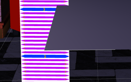

    But to what scale was the ruler made to, if to Poser's scale it won't give an accurate reading in Studio. Easy way to measure height in Studio is with a small plane primitive, translate on the y-axis till it just pokes through the top of the object you're measuring and read the y value (it is in centimeters).
    With ShareCG down, I don't know the first.
    On the second...so, in the picture above...I make a plane, it's flat on the ground, and rise it? Ok, I understand that.
    are all 3 axis in cm?
    Yes, I think I'm right in saying that all linear values in DS are in cm.
    Well, the ruler is set for Daz, if all the above is correct.
    So the plane is at the top of the stool, Y is at 94, so about 37 inches, which is where it shows up the ruler guide.
