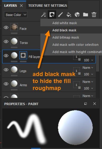

    I am not a Painter professional but in general it works like - well - a painting app smiley
    One quick example:
    (mistake, Fill should be above torso)
    EDIT: forgot to upload this screenshot.
    You can use all the alphas, change the paint color to less white etc. to control how strong the roughness map should be. Or you can use completely different maps and paint them in. Another way would be to use the height etc. channels of the smart materials and replace the DS maps with them.

    I apologize for not responding sooner, I actually know how to do all of that in Substance Painter (but it should be very useful to others, thank you for the good tutorials), my problem is that I don't yet understand why SP interprets the DAZ glossiness maps so differently than Studio does. Not sure if I need to invert it, make it much darker with filters, or something else in order to get similar results.
