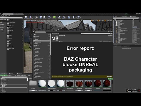

I hope this 4k video helps to find out what I might make wrong:
Sorry for my strong German accent. For better understanding, this is the script:
I created this to demonstrate my current problem. I cannot package the project containing a DAZ character.
While the UNREAL engine loads a quick info about my computer: It is a Ryzen 9 5900X 12-core processor with base speed of 3.7 GHz. It has 32 gbytes RAM and a NVIDIA GeForce RTX 3090 graphics adapter.
The current UNREAL project has a size of approximately 56 gbytes and has been realized mainly with blueprints. Only some time critical parts have been written in C++.
All software, this is UNREAL, DAZ and the bridge are installed on my 2 tbyte SSD which is the drive C: in this computer. I accepted all defaults during installation.
When I build a 64 bit windows package to be written to my 8 tbyte hard disk drive D:, an error message is reported very soon: DazToUnrealRuntime not flagged for being included.
In this attempt to build the project, the DazToUnreal plugin was enabled.
I used the Unreal engine to move the Engine/DazToUnreal files to the folder game/DazToUnreal/engine. In such a case Unreal changes all references to these files automatically.
As long as the plugin is enabled the DAZ 8 character can walk using my Unreal animations.
I was told to switch off the plugin as it is used for the transfer only. It was mentioned that it was not required to run my project. Therefore I turn off the plugin which requires a restart of the UNREAL engine.
After that restart with disabled DAZ plugin my character no longer can use my animations. It remains in the default A pose. It is true that I now can package my project without problems, but you can imagine that this is not something I can give out to my beta testers.
Enabling the plugin again and restarting Unreal, my character can walk again.
