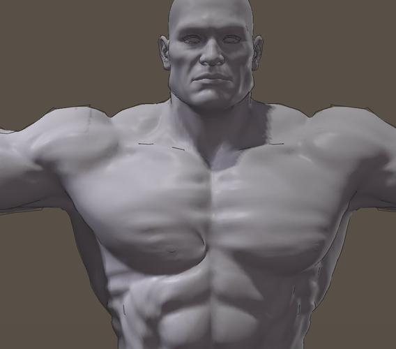

Hi, I'm having this problem where my F5 character has a crooked and contorted torso, pulling to the left of figures body.
See picture below.
I've tried reinstalling the F5 files over the existing ones, and rebooting computer, reloading Poser and character. Still doesn't help.
Any ideas on what this is and how to fix this?

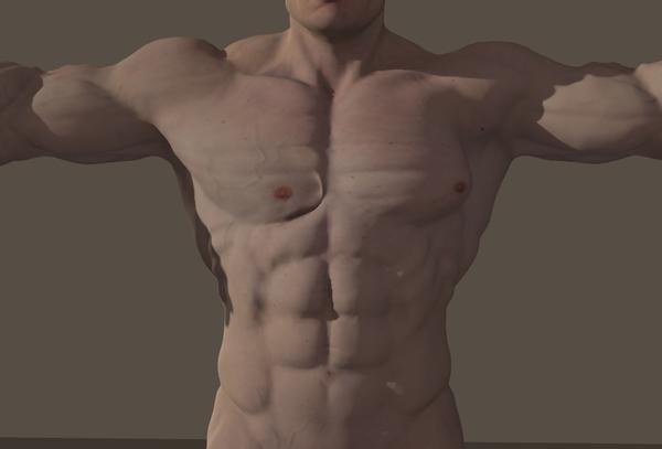

    By viewport I just meant the area showing the figure - click where it says "chest" and from the list pick Body Parts>Chest parts>Left pectoral (or PP2012 may not arrange the menu of bones by hierarchy, I can't recall when that came in, which case Left pectoral will be immediately in the body part list). As you can see, if I set the Side-to_side for the pectorals I can match the distortion you are seeing.

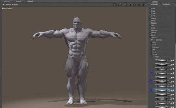

    The side-to-side is linked to the collar front-back parameter, but that wouldn't have any effect with the collar zeroed. I think it's most likely that you have one of the breast parameters (under Pose Controls>Torso>Female with the Body selected) set to a non-zero value.
