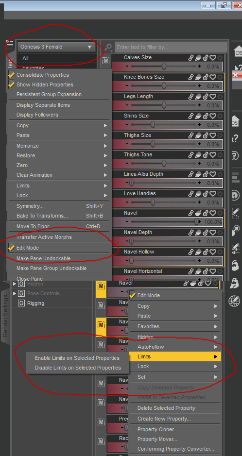

    I have an answer. This is from a user in 2016, Lissa_xyz, and it works.
    1 load a character;
    2 select said character;
    3 Right click on the Parameters tab, select Edit mode from the menu;
    4 now use Shift Left click select first parameter in the list, scroll to bottom, Shift Left click for the last parameter, (they will now all be highlighted) then Right click on the Edit Mode manu item, and select the menu item Limits, then Disable Limits.
    Here is Lissa_xyz's original picture showing this:
    https://www.daz3d.com/forums/uploads/FileUpload/46/e448c72c6c91499e4d73a47a88bbab.png
    This will disable all of the limits. NOTE: Be aware that doing this can cause some weird results, because sometimes the limits were turned on when the default number was out of range. I used Claudia Octavia to test, and her breasts were defaulted to 200. When I changed them her head went weird becasue her head and her body were set to 200, (which is what expanded the breasts) so I had to undo the breast, then lower the default Head and Body setting to 100. Then everything was fine. When you do this in the gross manner I have listed above - grabbing everything - EVERYTHING gets its limits turned off. It might be better to pick and choose on G8 or G8.1 once, then when you load characters, they have the limits turned off. That needs more experimentation on my part, but this will work on characters.
    Thanks to Lissa_xyz for the answer.
    ..Joe
