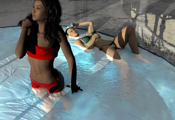

There seems to be a trade off in DS between the reflective and refractive properties of water. Last year I found the perfect reflective setting for water, 70% - however it lacked any refractive realism.
My obsessive quest for perfect refraction has culminated in this combination:
IOR/Index of Refraction:1.33
Refraction strength: 100%
Refraction Color (pure water): White (Refraction color may change for contaminated water)
Displacement mapped (see uploaded image): Strength 20%; min -3; max +3
Bump: unmapped
Specularity (pure water): Black 100% (specularity color and strength may change for contaminated water: algae, silt, etc.)
Opacity (pure water): White, 0%-5% (Opacity color and strength may change for contaminated water)
However, the surface has lost its luster. How can I get the shimmer back that I had before I fixed the refractive quality? It looks great if I were making scenes of snow-blown ice!
Diffuse: White 90% (according to aquatic science, but the surface still looks off to me. It might be the limitations of 3Delight.)
Gloss: 90% (?) (The scientific article that I read made it sound like gloss and diffuse were close to the same thing. I couldn't decide if they are inversely proportionate - meaning if the Diffuse is 90%, Gloss is 10% to equal out to 100% of the surface strength. The surface looks fuzzy, like frost, not smooth. I suspect that it might be the displacement map causing the fuzziness.)
I tried various ratios (Diffuse:Gloss): 90:90; 90:10; 10:90; 10:10; 90:100; 10:100; 90:0; 10:0 -- and the 90:90 ratio seemed to be the closest.
Reflection: 70% (according to science, but it disappeared because it seems to be dependent on opacity strength.) I even ramped up the reflection to 100% with no effect.
What's going wrong here? Is it the displacement map? Displacement is the only thing that's mapped in these settings. Does it have to do with opacity being so low? Should I be using the Reality renderer?
1348 x 921 - 2M
1996 x 1498 - 6M
    edited November 2014

    Thanks to both of you! Your advice helped a lot.
    New settings
    Diffuse: White 10%
    Gloss: 90%
    Multiply Specular Through Opacity: OFF
    Specular: white 90%
    Opacity: 5%
    ---In regards to the issue with reflection off a low-opacity surface, there is a formula: Reflection Strength A/Opacity Strength=Reflection Strength B. In other words, the scientifically accepted reflectivity of water is 70%. In order to get 70% reflection from an opacity of 5% you need (70/5) = 14 or 1400%. So, with limits removed... (my tutorial for removing limits on any surface property can be found here: http://dazinablender.deviantart.com/art/Daz-Tip-Point-Lights-Unlimited-481273508)
    Reflection Strength: White 1400%
    Refraction strength: White 70%
    IOR/Index of Refraction: 1.33
    Here's the final result. No postwork.
    As far as I'm concerned, mission accomplished.
    1348 x 921 - 2M
