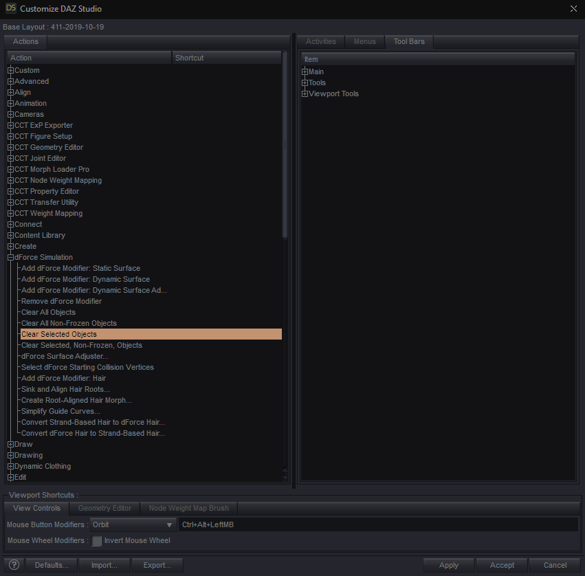

    I wish it would only clear the selected item as well.
    However, you can create a custom action for only clearing the selected item by hitting F3 and dragging the menu option to any active toolbar you would like.

  • WendyLuvsCatzWendyLuvsCatz Posts: 41,830
    OOOOOH that's a hidden gem

  • You could use the Simulate command from the option menu, or use Window>Workspace>Customise to put a button for it on the tool bar. That way you won't be going anywheer near the Defaults button.
    Yes, thanks. But it's hard to believe that such a workaround is necessary and that the default layout and behaviour is so stupid.
  • DartanbeckDartanbeck Posts: 22,159
    Holy Crap! Thank YOU So Much!!!
