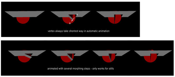

    But!:
    This alone wouldn't work to animate e.g. a door. The hinges are not the problem here, it is the automated animation that tends to deform the door. It is always looking for the shortest way for all the vertex to travel, it is not looking for the "perfect bow" you think of.

    That is what I am seeing. It is moving in a straight line, thus deforming the door.
    Thanks for the link. Will take a look.
