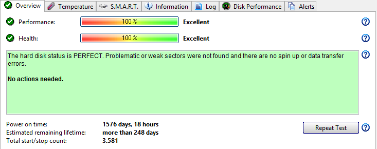

    sriesch said:
      Regarding the OP's hard drive issue, did he purchase the HDs from a reliable source?  I've heard unconfirmed rumors of the massive numbers of used drives from data centers being pawned off as new.  Might just be nothing more than a fake rumor, but the potential exists and if he buys them all secondhand (intentionally or unintentionally) that might reduce life expectancy if the used drives have been running nonstop.
    Unless there is a way to reset the SMART data they will reveal the power on time (the total time the disk has been spinning).  But you have to check these data of course, which many probably don't do:
    733 x 290 - 25K
