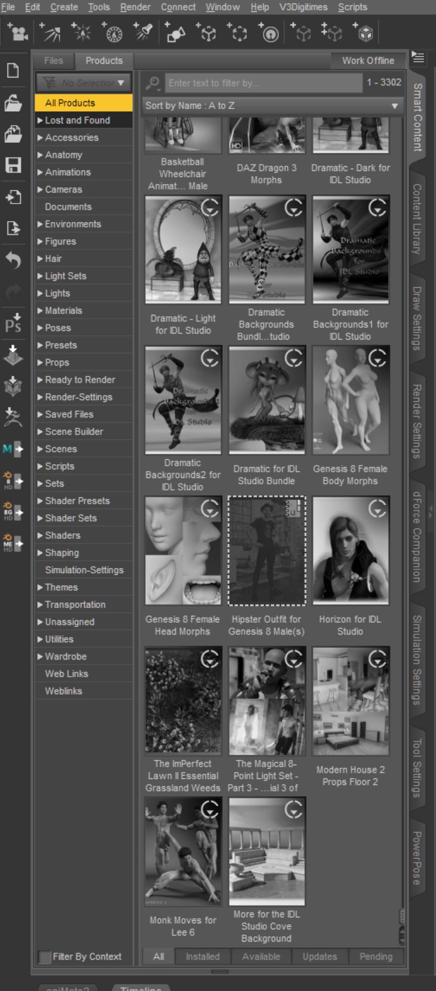

I know I have discussed this before but I forgot how to fix it.
The grayed out products at the bottom of my all products list in the smart content folder...
How do I reinstall them so they work?
I have been told not to right click and install them.
When I open the install manger and locate them, uninstall them and reinstall them it does not fix the problem.
Any help on this would be much appreciated.
Thanks in advance.

  • Richard HaseltineRichard Haseltine Posts: 111,516
    If the Content Management System is not seeing them as installed through DIM/Daz central then make sure that the CMS is actually runnign while installing (if you close DS and immediately open the installer it is possible for wires to get crossed - better to leave DS open or to wait a while before starting the installer0. If that doesn't seem to be the issue then there is some kind of communication issue - installing through DS would resolve it for those products (and I think people are unduly phobic about the feature) but wouldn't solve the underlying problem.
