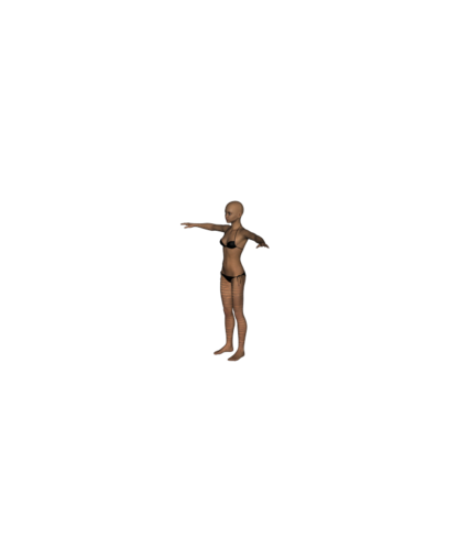

I'm getting a weird crosshatching on my skins after rendering (pix Included)
halfmast88halfmast88 Posts: 63
edited October 2014 in New Users

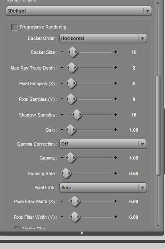

I'm getting a weird crosshatching on my skins after rendering and I don't know what to do about it. It happens when I am zoomed away from the character a bit. I have included an example as well as the render settings used. It should be obvious what I'm talking about, the black lines on the legs, right forearm, and the visible seam behind the ears and across the head (that isn't very visible in this render). -Thanks

  • SimonJMSimonJM Posts: 6,102
    That looks to be banding caused by the AoA SSS shader on a small (distant in scene) item - you need to adjust ... um, something! Shading rate (I think?). There is, I believe, a preset you can apply which should do this automagically for you.
