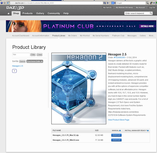

    Well I took the liberty to manually downloading the thing from the site. search for "Hex" in the "Product Library" thing...
    1002 x 974 - 353K
    Well, whether you download with DIM or manually I don't think matters.
    BUT I would highly suggest installing it manually. W7 can be quirky about DIM installing even itself.

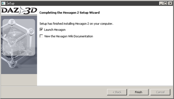

    Find the .exe whether you have it downloaded to and install it to its own program folder [i.e. NOT in the protected Program folders of W7].
    Hexagon is an older program and now and then there can be a burp because it wants to do something in its program folders and W7 guards those from change. So for example, on the usual main drive --- C: MyPrograms > whatever .....

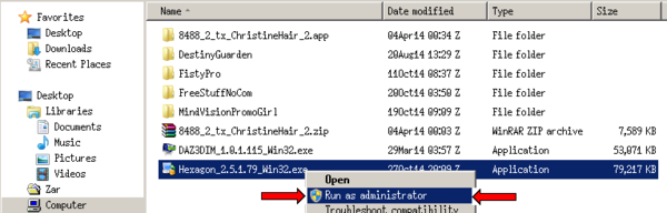

    Oh yes, install by right clicking and run as Admin. When it has installed, right-click on the program icon and run as Admin. On its first run, it should pop up a box to put the serial key into. Do that ... I think you might have to type it in. There's one scenario with one of the programs here which requires manually input, copy/paste not working. However if copy/paste works, that's good.
    Then you can close Hexagon and open it as you would normally.

    Oh yes, install by right clicking and run as Admin. I don't know how many times I still forget that, as there was no such thing before Windows 7, for me (VAX-11/VMS, BSD, DOS 3.0, Win 3.11, win95, 98se, XP).

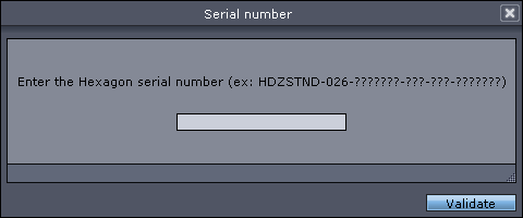

    I hope I did this correctly. I'll redo the screen-caps after typing in that cypher-code-thing.
    Your cypher-code-thing is listed on the web-sight under "My Account", in the "My Serial Numbers" tab. Assuming you actually purchased the thing.

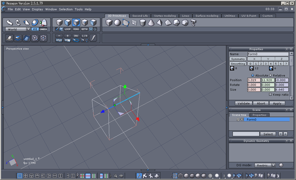

    Well, that was rather uneventful. No validation successful box? Just disappeared revealing the default Hexagon interface???
    Dose this look correct?
    1092 x 675 - 93K
    Yup. Now you can click on say the box cube, then click in the grid area and start modeling :-)
    If the key didn't work, Hexagon would have closed ;-)

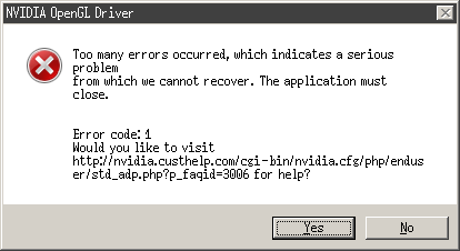

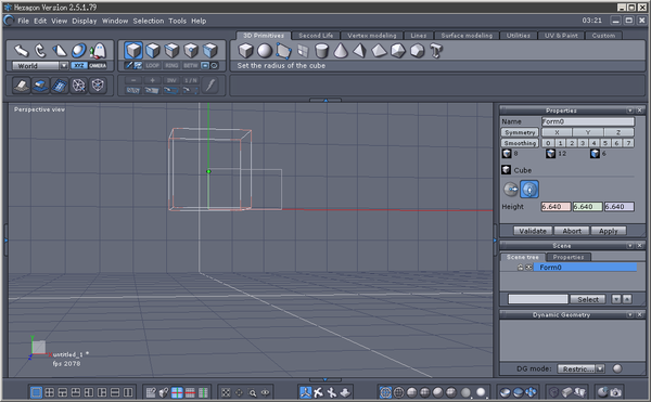

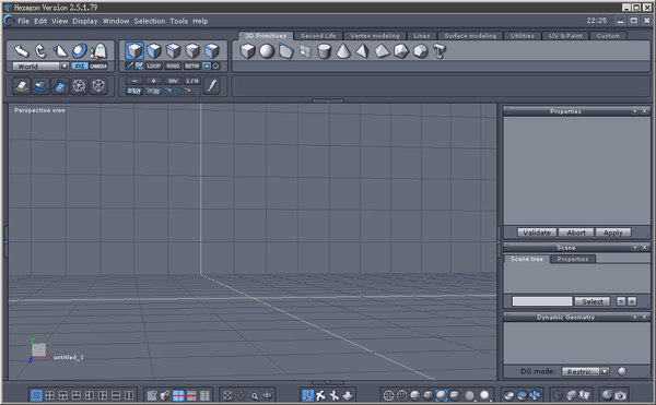

    I go to add a cube to the scene. First click is O.K. sort of. When I go to move the courser after that first click, ALL my monitors do this weird Black-screen strobing effect, then this error appears. The strobing stops the instant the error appears, and clicking either option just closes Hexagon. The drivers are up to date by the way, I just checked that.
    Are y'all sure that is all there is to installing Hexagon?

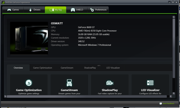

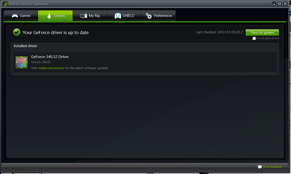

    Added the machine specs pic. It is by no means a "Watt-hog" graphics card, tho it dose have lots of pipes to keep it cool, and idles at a minimal wattage.

    Hmm ... that is not good.
    This may help:
    Edit > Preference Editor >
    User Interface:
    uncheck Check DAZ news [not going to a valid link so no point]
    maximum undo levels, dial that way up.
    3D Display:
    OpenGL optimization "no ..."
    When done, click Validate at the bottom of the editor's window.
    Close Hexagon, Open Hexagon.
    Hopefully it'll work.
    Sometimes there's another issue with video cards which hopefully somebody else can address. I'm not that tech savy.

    This is the first time I have ever seen an Application cause Both Monitors to blink like this. Not with UT04 or even 3Dmark has that second monitor ever blinked or budged in showing my system stat. I'm also noticing that on resizing the hex-window, the icons on the lower edge, start doing that weird overlap effect that goes nutsoid as I pass the mouse-courser over them. The Strobing only seams to occur in the "Perspective View" pane/window thing, The instant the courser gets over the surrounding menus of off of the window entirely (assuming it hasn't crashed by then), The strobing stops. The faster I move the mouse-courser in that "Perspective View" pane/window thing, The faster the strobing. This is absolutely 3D graphics interface related (3DFX/OpenGL/Active-X/CRAY-Vector-X/etc).

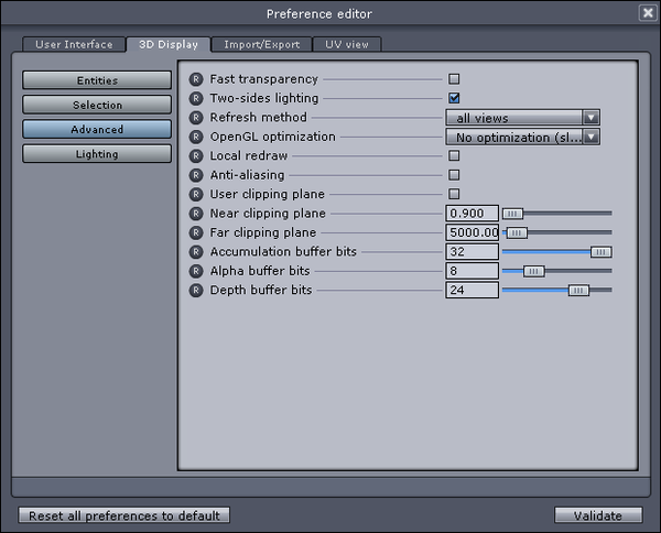

    In searching for that 'Daz news' setting I stumbled on to this nid-bit. "Anti-aliasing" in exes of 4x... Some of the older cards just can't do that smoothly, and turning it off in Daz Studio did make the View-Field respond much smother. The 8600GT has like four dumb-cruncher-cores and a semi-calculator-core... Equivalent to about a sixteenth-of-a CUDA core :roll: . Granted I think this has to do with blinky highlight outlines, If it is 16x or Off only, Off may be best on older GPUs.
    I Need first-coffee, I will continue this thought after trying those settings. Thanks, and Please keep the advice flowing. :coolsmile:

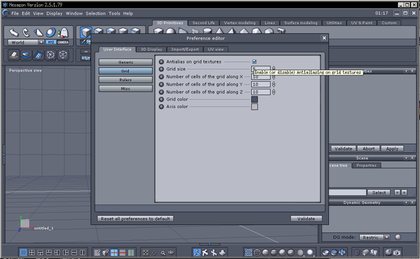

    1093 x 676 - 89K
    edited October 2014
    After looking at this settings window, and digging for definitions. Are the default bit-numbers to high?
    Alpha Buffer Bits;
    OpenGLPixelFormat (int bitsPerRGBComponent=8, int alphaBits=8, int depthBufferBits=16, int stencilBufferBits=0) noexcept Creates an OpenGLPixelFormat.
    Accumulation buffer bits;
    void glAccum(GLenum op, GLfloat value);
    op; Specifies the accumulation buffer operation. Symbolic constants GL_ACCUM, GL_LOAD, GL_ADD, GL_MULT, and GL_RETURN are accepted.
    value; Specifies a floating-point value used in the accumulation buffer operation. "op" determines how value is used.
    Errors;
    GL_INVALID_ENUM is generated if op is not an accepted value.
    GL_INVALID_OPERATION is generated if there is no accumulation buffer.
    GL_INVALID_OPERATION is generated if glAccum is executed between the execution of glBegin and the corresponding execution of glEnd.
    (etc).

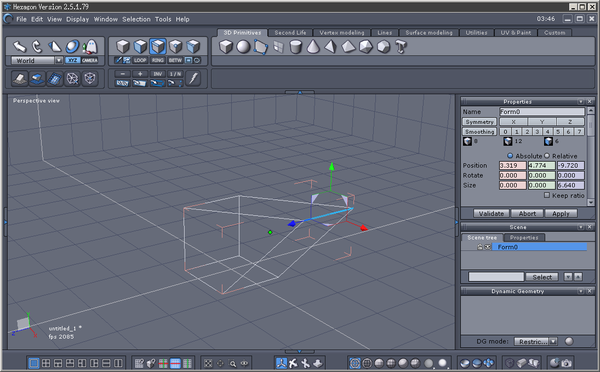

    Hmmm. Where do I get to that Error log. (EDIT; Never mind. The one thing I changed in this screen-cap did it!)
    620 x 500 - 19K
    edited October 2014
    OpenGL optimizations set to "No Optimizations".
    Success! At lest for the second part of putting a cube in a scene. Screen-cap is at the exact stage things had gone, strobe. Thanks Patience55.
    1092 x 675 - 103K

    I also picked up this tip, elsewhere on the forums about video card settings on modern computers
    There is a bug/problem with Hexagon attempting to use multi-processors.
    Please try:- Open nVidia control panel-> Managed 3d settings. Change the option:- “Threaded Optimization” to “Off”

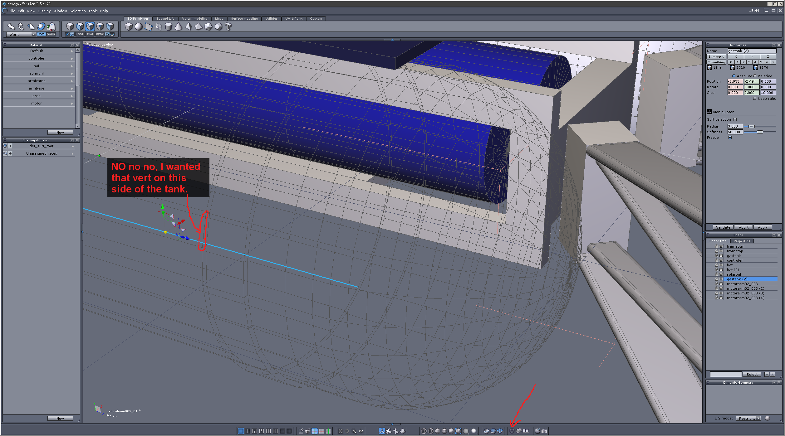

    ok, many years later, as I tried to remember how I got hex to work over 10 years ago, for a newer comp. I kept having an issue with selecting stuff through an object on the opposite side. I spent the past hour looking through the preferances window, and googling to no avail, lol. Screencap from Fisty, thanks.

    Not sure what you mean re: "through an object on the opposite side"?
    FWIW, I've installed Hexagon twice in recent weeks on newer computers running Windows 10. Worked on the newest one, a 2019 model, and ran really slow on a slightly older machine.
    Downloading and installing with DIM has been a bit hit and miss. )-:
    edited January 2021
    yeah, for DS and Hex, DIM can be hit or miss.  as for selecting 'through' an object to the other side, for example, I was trying to select rings on this tank to resize them, and hex kept randomly going for the vert on the far side, if the mouse cursor was to close to it on the screen.
    as said, the fix Fisty pointed out addressed the select through an object issue I was having.
