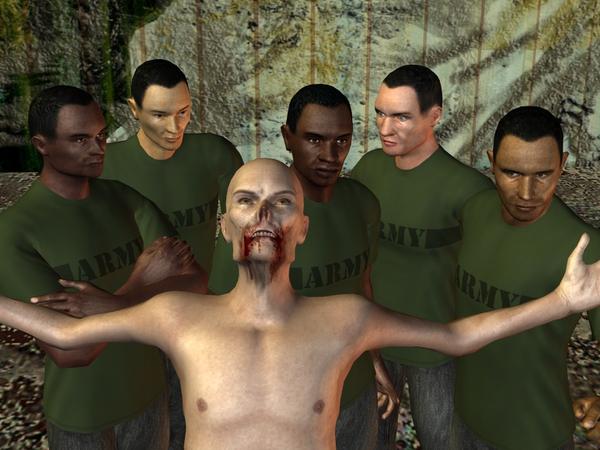

    I forgot how versatile these guys were
    L to R: Indian, Oriental, Zombie, African, Caucasian, Hispanic

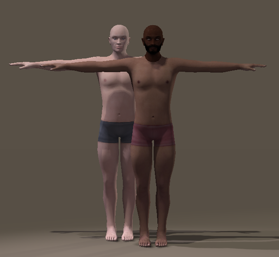

    SpottedKitty, thanks for checking. I tried downloading again, and it didn't change things. I'm on a Mac, running Poser 10, and I only downloaded the Poser files for the pack. Here's a pic showing the stock Lorenzo, and one to which I added the skin mat and facial hair:

    Also, I did a quick render, and it looks the same. I suppose reinstalling the program is the next step, but I'll wait and see if anyone has a better idea before I try that.

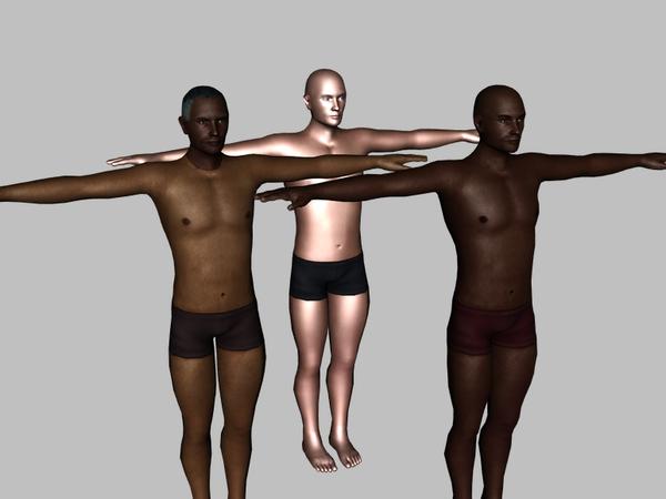

    It kinda looks like the wrong base map was applied. Most the hair/beard shaders only change the head. It looks like you've got the Hispanic/Indian shader on the body. Check the Shader tab and see which base shader you have appied to the body parts. I see the same line at the neck on this test.

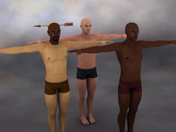

    I might be wrong on this, the only other body base with red underwear is the oriental and that's too light. Maybe missing specularity map?

    MarcCCTx, I double-checked, and I'm definitely clicking African. Loretta seems to be fine, so I'm pretty sure this is a Lorenzo issue. I tried some of the other races for him, and I'm having the same problem with their bodies too; I'm attaching the white guy with the skin map and the head/hair map. How do I check on the specularity map?

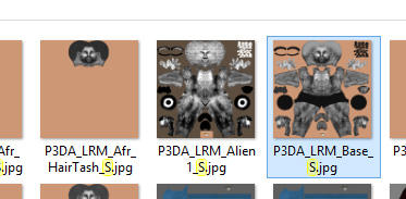

    Well, if it's a corruption issue check the files in "Runtime\Textures\P3DA\LoRezII_Male" the specularity map seems to be "P3DA_LRM_Base_S.jpg" just see if you can open it at all, if the file is corrupt, reinstall, if it seems to be ok, make sure that your using it and not one of the other's.jpg files, I notice that all the head specularity maps have a Caucasian background instead of the grayscale bump map look.
    If it's not that maybe look at the other files for some corruption, other than that, I'm not sure.
