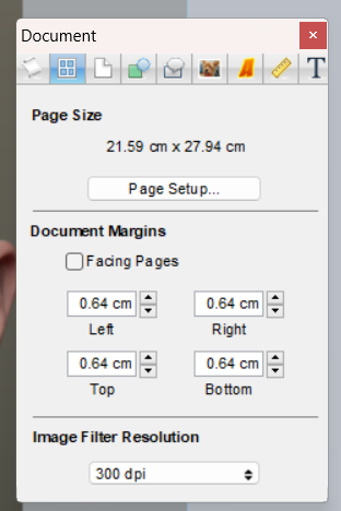

    I've just been adding in programs to my new laptop which is why I thought it was my eyes. Glad to know it isn't.
    In poking around some settings, discovered that the image input was not set to 300 as well. So it is now and yes this makes a difference.
    Think this is the "inspector" tab.
    Changing this setting did nothing for pages already rendered, unfortunately.  Not that I noticed, anyway. It still looked slightly blurry. Reflections were still dimmed and skin detail was still completely smudged over too.  The options for opening or creating new pages doesn't seem to list that as something you can change, either.
