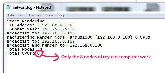

I have this peculiar problem. I have 2 computers, one with 8 nodes (argus1000) and one with 24 nodes (George-PC). I have disabled the firewalls on both computers. I have set them both to enable network rendering. My network is hardwired. Both my computers see each other, as my node rendering manager pic shows. I even see the grey Ns at work, but they are ineffective. Where do they comes from?
Because still only the 8 nodes of my old computer work, not the 24 nodes of my new computer, as my log file shows. I am baffled.

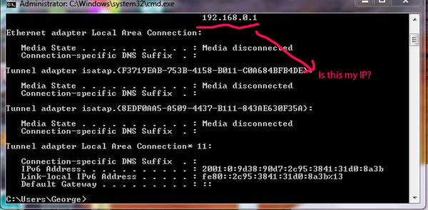

    192.168.0.1 is the IP of your router/DHCP server. (can't help with the other stuff - sorry)

    I PM'd boojumbunny, who is the recognized authority as far as render farms are concerned, and he says that I don't have to buy the render grid. That is not my problem.
    So I decided to reverse the situation. Instead of my 8 node computer, I assigned my 24 nodes computer to be the master and my 8 nodes computer to be the slave. And it works! So it looks like I don't have to buy the render grid (not yet anyway).

    @Argus, open your other computer Network/IP settings and you'll find the local IP address for that specific computer there. You may be able to set it as well. Carrara will not dynamically "find" other rendering computers, the address needs to be specific.
