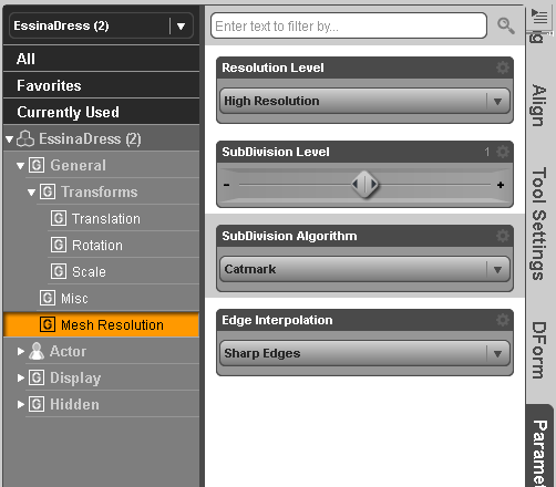

    One side note, cloths. some items do take up lots of ram, others not so much. I once dumped my computer with just three cloaks, nothing else just the cloth. That was back in the 2GB ram XP days a few month back.
    This has been on my mind, as I wanted to set up an army, and ran out of ram after four figures and the outfits. Looks like almost every item is at "High Resolution" and "one" SubDivision level. Yet setting this to "Base" resolution level, and zero subdivision, dose not appear to immediately show right now, tho the comp has been at it for a few hours. It may be time for a reboot any anyways. (EDIT, yea something else is eating up 4GB, and I bet it is the browser.)
    Do all of the figures need all of there clothing items at maximum detail and polygon count? something to think about.

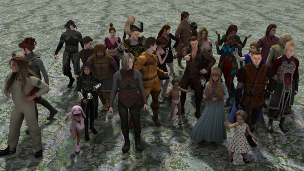

  • WendyLuvsCatzWendyLuvsCatz Posts: 41,848
    edited October 2014
    I actually am going to take back everything I said
    I just tested, V3 and M3 use A LOT LESS RAM than Genesis loaded into DAZ studio
    22 Genesis I hit 15GB
    naked
    28 V3 ,M3, M4 and V4 was around around 5GB
    I am dressing them all now and only have hit 15GB with nearly all dressed fully
    since I only have 16GB may not finish
    Textured or untextured?
    textured
    not only that I have now dressed ALL of them and only hit 15GB
    2000 x 1125 - 2M
    2000 x 1125 - 887K
  • ScavengerScavenger Posts: 2,677
    So was the info on the polygon count wrong? Or is it that the V3 was done with lower res textures and stuff makes the differencE?
    I messed around a bit with the Object/Texture atlas earlier...I got a bunch of maps out of texture atlas, and when I applied them...well, the object was colored, but nothing really looking like the way the base figure did.
    I'm right now trying a few G2F figs with their resolution set to base. Might back out from there though and try the V3 route, then..especialy with the freebies that Daz just put up encouraging it:)
    edited October 2014
    I used them all as is
    I have 16GB RAM it uses 15GB all up with hairs and took 16mins to render with one light and UE1
    I think genesis triax info and data the issue, I have an awful lot of morphs, the older figures only added needed morphs to each to make different
    277 x 347 - 23K
    394 x 719 - 68K
    2000 x 1125 - 4M
