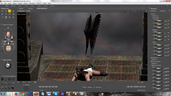

I'm trying to use Feathered Wings, and I have always had a problem with them and I can't figure out how to fix it.
Whenever I use Feathered Wings they refuse to stay on the back. i.e I will load them, conform them to the figure. I can move the figure and they will move with it. But if I try to say, put the figure on his or her back,or on the knees even, they end up somewhere completely different...
I added some pictures.
The same thing happens when I try to just parent the figure to his torso because that seems the most logical place to put it....
When I move the figure around the wings still move but they're still nowhere near his body and I have to do so much crap to put them where I need them to go.
This doesn't happen with any other figure I have and I don't understand the problem.

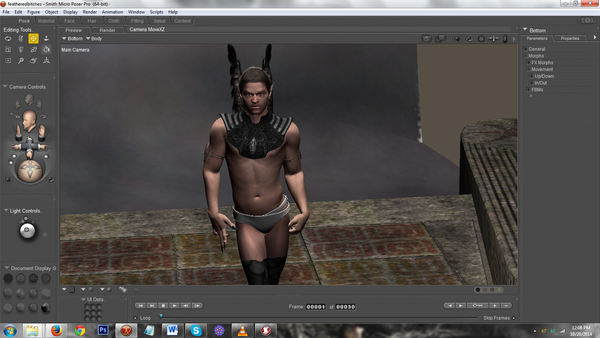

The first pic is what they should look like when I have them on him when he is standing (a preset pose has been use)

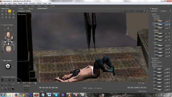

and then another two pics where I again used a preset pose and they ended up in the wrong place.
1600 x 900 - 1M
1600 x 900 - 2M
1600 x 900 - 2M

    Yeah, I tried parenting it to his chest and it does the exact same thing.

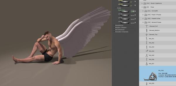

    How are you parenting the wings? I used Figure>Set Figure Parent... to parent them to M4's chest and as you can see they remain attached after posing M4.

    I've done that, and I've right clicked them and parented them to M4's chest, but he still does this..
    Is it because I am using preset poses? I don't see it happening as much when I move him directly, but I am terrible at poses so I usually use a preset pose and then alter it to suit my needs.

    As you can see for my screenshot, I used a preset pose (one of the M4 General Poses if you want to test it, it is possible that there's an issue with some poses so that would be useful).
