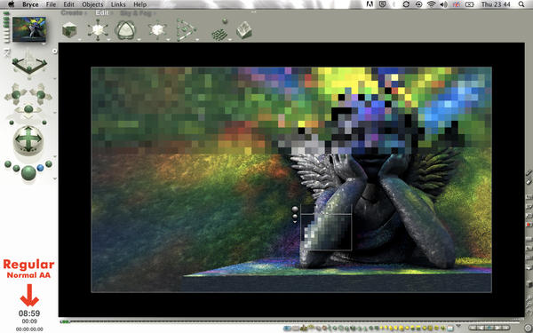

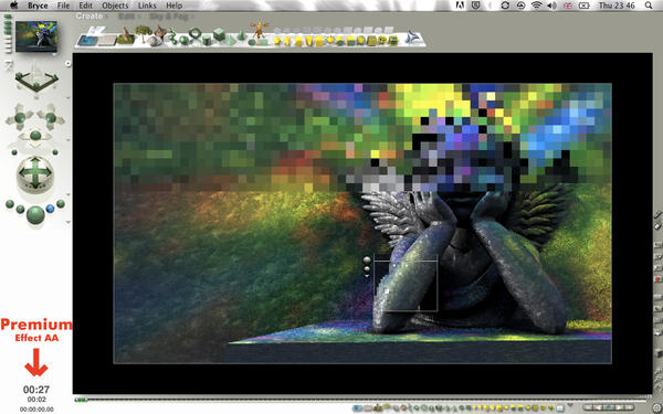

    Just done a quick example on the render I'm working on tonight:
    I only did a plop render because it would take too long to show a full first pass, so in all three cases the exact same sample from the render has been given one pass and I've highlighted the Bryce Estimated time (not usually particularly accurate, but a good indication).
    The Premium Effect AA and the Super Fine Art AA examples used exactly the same settings for RPP and AA settings in the render options dialogue box. None f the Premium Effects were switched on in the Premium Render.
    Super Fine Art AA rendering is by far the longest render time (and you've then got to add the time for the AA pass which Bryce doesn't add into it's estimate, whereas the Premium Effect render doesn't need an AA pass so the time difference is even more than shown in the figures here and you'd have to agree that for exactly the same render quality, why would anyone wait 40 minutes for a render they could get done in 29 seconds. :cheese:
