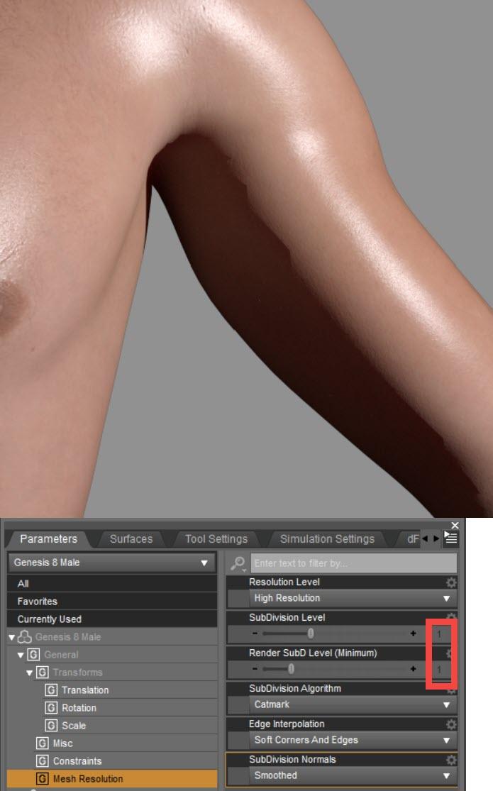

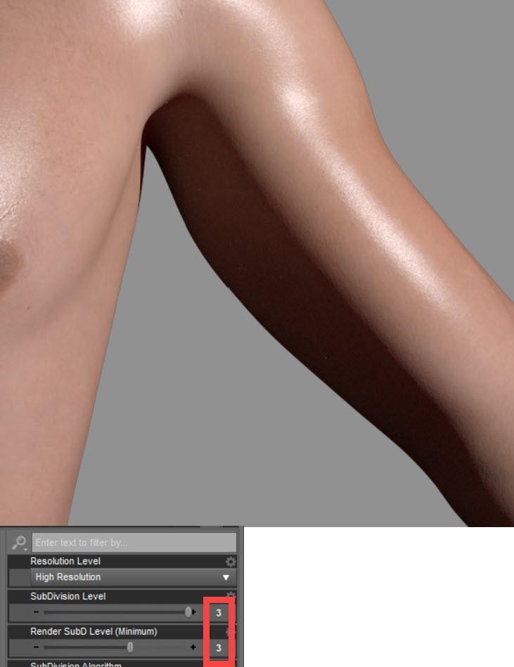

  • AnimAnim Posts: 241
    edited March 2021
    @Hellboy
    maybe increasing the mesh resolution can help (hopefully you have not already maxed it out). By the way, the issue is still there in the render without bump but less obvious - check the edge artifact on the lower arm.
