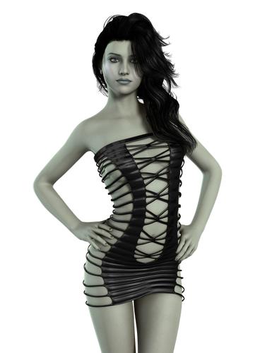

Typically, I used to use the beautiful green skin from this:
http://www.daz3d.com/frankie-von-stein
But, for obvious reasons, it's only useful for Genesis 1 females. Not Genesis 1 males and certainly not G2F.
If this will work for you, Here's a link to the Recipe Card: http://www.draagonstorm.com/tempdl/GreenGirlRecipe01.zip

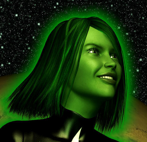

I'm not familiar with the product, but maybe my settings for the standard Human Surface Shader can get you pointed in the right direction. Here's what I did to create the skin tone used in the attached image:
I started with the V4 Elite Lana texture (though any light skin texture will do). I changed the diffuse color to 120, 192, 120, leaving the map the same. The subsurface color I changed to 220, 255, 216, and I changed translucency color to 65, 195, 76. I left all the other settings the same. Essentially my technique was to apply a level of green to both the outside and inside of the flesh. The lights I used in the scene also had some green and yellow in them to help bring out the color in her skin.
Thank you, both!
Draagon, that's the first time I've used a recipe card (and it had me worried, as there's what looks like a faux error message and it hangs for ages, but it eventually gets through). Your version was good, though! I just needed to manually alter the diffuse colour setting, a little (then play around with Skin Builder's cosmetic options for the lip colour) and got a fairly good Orion.
Morgan, those values and settings helped a great deal for exploring the manual method. Similarly, I needed to play around a little more, but that certainly helped to get me in the right area.
