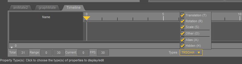

    I'm creating an animation at 12 FPS, but I din't succeed to generate particles animation at the correct keyframes :( Eveything is incorrect in the timeline, the particles duration is wrong as well as their position and so on. In my scene, I have 54 frames at 12 FPS, I would like the particles simulation starts at the frame 23 and finishes at frame 50 (I put "Active production of particles" ON/OFF at these positions). When I put 12 FPS parameters of PARSIS, no particles are generated so I have to put 30 everytime and I have to use a wrong "Number of frames" parameters, it should be 135 (for 54 frames at 12 FPS). But everytime I run the simulation, the particles are only generated for 16 frames and starts a lot sooner I would like (at frame 13). I tried with a lot of "Number of frames" random numbers but it doesn't seem to change anything :(
    Please how could I fix/achieve that ? I just would like the particles correspond to my keyframes on the timeline.

    Hi, Kervala!
    The problem is that Parsis always starts the simulation at frame 0. If you set the mesher's Completion to 0 % at frame 23 and 100 % at frame 50, the simulation will appear between these two frames (if not, re-synchronize the mesher by disabling and re-enabling it). But the simulation won't be synchronized with the objects in the scene. There are two possible independent solutions:
    1. Split the animation of the scene so the simulation can start at frame 0.
    2. Or, before running the simulation, set the Production rate of the sources to 0 at the frames 0 and 22, and set it to 100 (or whatever rate you want) at frame 23. The Completion of the mesher should be 0% at frame 0 and 100 % at frame 50. Use the same type of key interpolation in Production rate and Completion keyframes to assure synchronization of the simulation with the mesher. Note: The number of frames in the Parsis Engine node (or the Parsis Pane) should be set to 50 in your example.
    Every time you change the number of frames of a simulation, you have to disable and re-enable the mesher if it was enabled during the running.
    If you have any more questions, let me know, please.

    Thanks a lot for your reply :)
    Yes, I always start the simulation at frame 0 and stop it at frame 53. I'm sorry, I used the wrong terms, but you're right it'll be easier to use "Production rate" instead of "Active production of particles" :)  And I didn't remember about disabling/enabling the mesher :) Thanks for your advices, I'll try them :)
  • kervalakervala Posts: 186
    I confirm, it works perfectly now :) I suppose the problem was I didn't disable/reenable the Mesher when changing the number of frames :s
