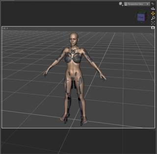

Okay, that's worked ! (And yes, I put it wrong, I want to use the CyberV4 model as a "skeleton" for genesis 8, because it should be under the genesis 8 model!)

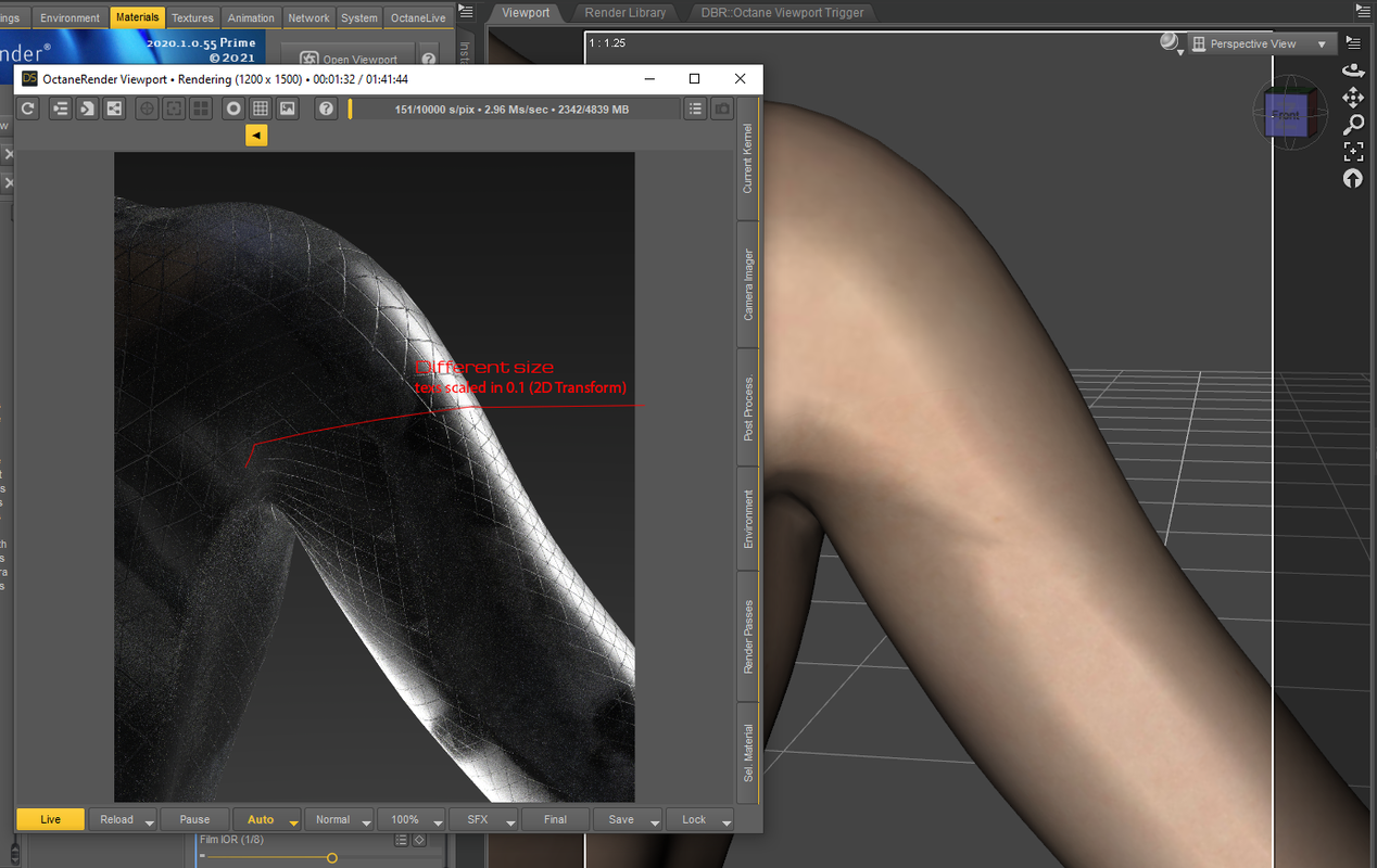

But I have another question about the transparent plastic shader (on the example image), it's definitely a texture with a opacity layer.
I made a similar one using three textures (roughness, height, and normalmap).
But here, too, most likely a specially made set of shaders/textures for iray, I can't find it.
https://i.postimg.cc/8P2ZpnB3/Screenshot-1.png

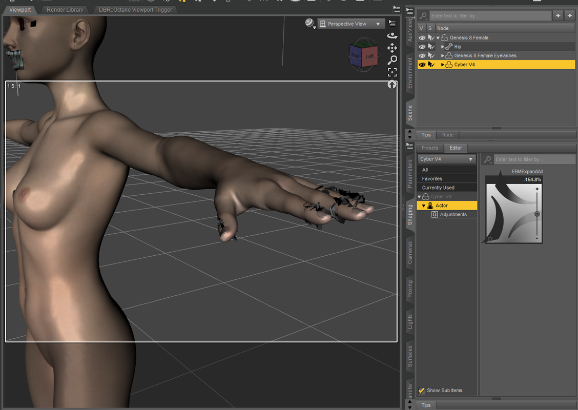

UPD : When I apply CyberV4 to genesis 8, some parts of cV4 still stick out, and I just reduce the cyberV4 model itself so that they are not visible but all that scale is breaking mesh parts :(
https://i.postimg.cc/ZKkX5cmW/Screenshot-2.png
