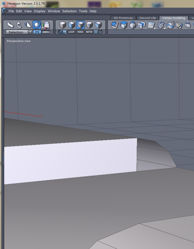

I am trying to create a depression in the top of an object which has beveled edges. I've cut the opening and have bridged from one side to the other, but I'm having problems creating faces to close the opens on the sides.
In the screen shot you will see the center portion of the side has been closed, but the odd shape at the right side is still open; the opposite side is the same as in the screen shot. I'm not that familiar with Hexagon so closing this odd shaped area is posing a problem.
What is the best way to make a recessed area when the sides are beveled and the top of the object is flat? That is the problem I've encountered and am not experienced enough to know how to solve it.

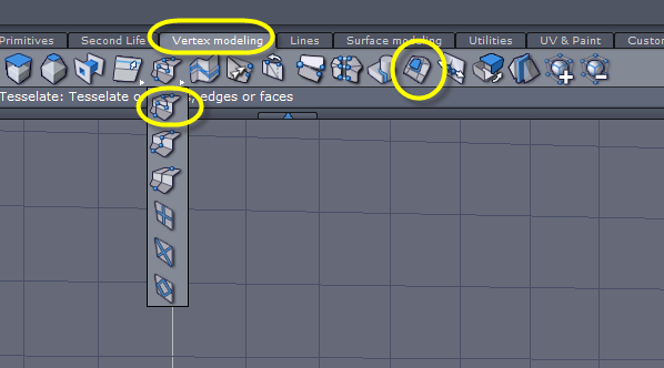

    There's a button called "close Holes" which usually works well for these situations. You click it, it'll put a white circle around everything it is recognizing as a hole, click near to the white line and it'll turn red. Validate after filling the desired holes. Then you may wish to use the add a line from dot to dot tool so those 3 dots get connected to a corner as well. Having dots end mid line tends to cause trouble later on.
    edit: Or, depending upon the item being worked on, use the 3rd add a line button down in the image to add 2 more lines on the straight plane, then bridge 2 of the curved lines with 2 of the straight. Then use the close holes button to fill in the left over triangular space.

    @Patience55: Your first suggestion worked like a charm, so far. I tried it on the section I showed in the screen shot and that area is now closed. Before finishing this post I tried this on the other three areas and they too are now closed. As a result a line was left between the triangle area and the center area. It was then a simple matter of removing the lines and the stray vertices. I now know what another command does, which is one more than I knew. Thank you Patience55.
