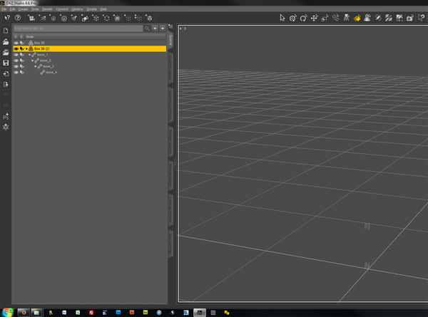

So I got a freebie from MostDigitalCreations called "Pandoras Box 39" and the image below is what I get when it loads in DS. Any idea as to how to fix it? I contacted MDC and they said
It must be a bug with Studio because it works fine in Poser. I've had a look at it and I can't find a reason why it wouldn't work in Studio.
Just one of those things. Sorry
Which is no help at all really, but I should warn you although the screenshot is well-within the realm of common-decency, the actual prop is likely some kind of adult toy, which all of their "Pandora Box" props have been in the past. So if you go downloading and testing, be prepared.
Link here: http://www.most-digital-creations.com/pandoras_box_39.php
you need to give your email addy to download it too.
1213 x 900 - 231K

    Any messages in the log file?
    I had something similar with a prop from 'rosity (Breached Hull) and the vendor supplied an update to fix it.

  • SimonJMSimonJM Posts: 6,101
    That looks to be a similar set of messages that I got (from memory) so there should be a fix, it's down to if the vendor can be bothered or not, and if it's a freebie I am guessing not. You will probably find it will load in DS3 (if you have it), so something has changed to make DS more strict with it's 'sanity checking' of data.

  • FistyFisty Posts: 3,416
    See if you can import the .obj from the geometries folder.. unless the creator was really lazy and didn't rip it out of the .pp2 like you're supposed to.
  • jimmulvaneyjimmulvaney Posts: 341
    That worked! There are bones in it with an overall "material" zone but only two main bones are actually being used. I saved it as a Prop asset and now it is all good. Thanks!

    Hi Cathy, wow sorry it took me so long to get back to you on this. I don't usually check the forums that often and jus now I was cleaning out some of my bookmarks. Anyways here is your step by step from memory...
    File > Import> (locate the object file in your Runtime) Runtime > Geometries > PandorasBox > Box 39.obj When you get prompted for import options I generally set the FROM preset to Poser (all depends on where it was made in/ for because each software handles dimensions differently in a 3D space, Poser is generally a safe bet) Click on Accept. Oh my that is VERY NSFW! No screenshot here.
    Next highlight the item in the Scene tab, go to File > Save As > Support Asset > Figure/ Prop Asset. Give it a good identifiable name  like "PandorasBox39". click Save. In the options I just go with teh default ones and click Accept.
    Now make a new, empty scene and in the Content Library tab you can usually find it in Daz Studio Formats > Content Library > Figures > PandorasBox39.duf
    Double click it and it is as basic of a DS prop as can be. lol If there were articulated parts to it then it is much more complicated and outside of my comprehension. Best of luck to ya!
