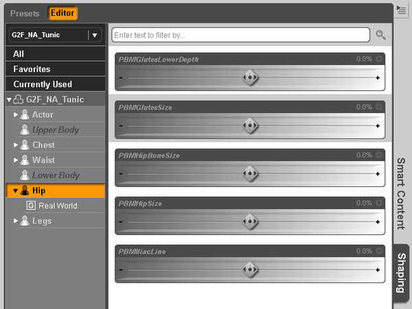

  • FistyFisty Posts: 3,416
    Doesn't that create a morph slider or something? I need to find that hexagon bridge vid again, with the nose morph.
    When you send it back to Daz Studio, the morph slider is at 0%, and you need to find and dial it back up.
    yes, if you don't overwrite existing you have to go in and find your morph
    edited October 2014
    In this tab with the other shaping for the dress? I didn't make any morphs. Just fixing underwear poke-threw.
    1395 x 695 - 207K

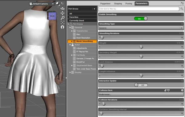

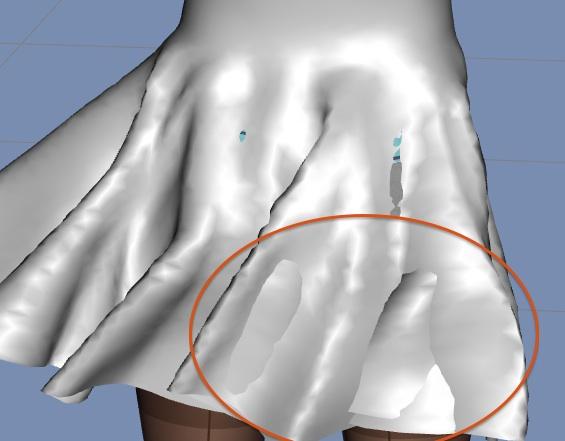

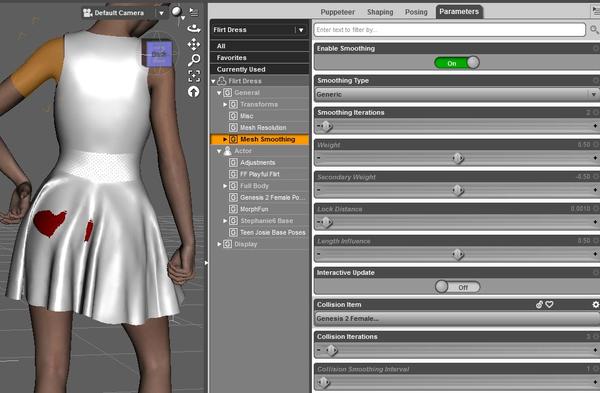

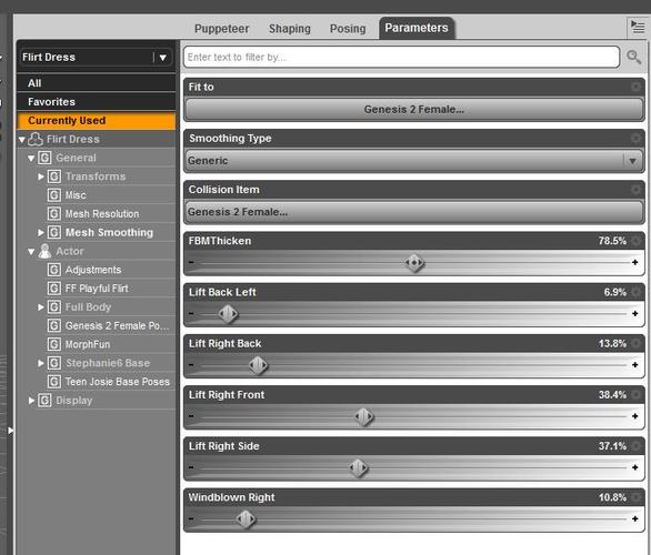

  • SimonJMSimonJM Posts: 6,100
    Just had a go with this and that particular area (top of the buttocks) does seem to be a bit of a problem - none of the morphs and tweaks quite did enough.
    What I did in the end was to get the dress just about right and set the collision item to be the basic panties and that seems to have done what is needed.
    1068 x 678 - 119K
    697 x 595 - 85K
    1031 x 675 - 117K

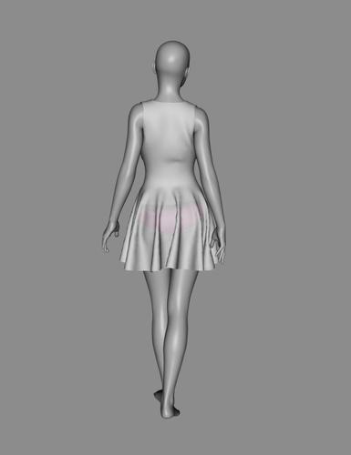

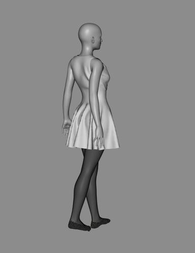

    Here's an image of the dress on G2F pose 04 and the corresponding draping/pose matching morph, with the basic underwear underneath I selected the dress pelvis and set X and Y scaling to 102. Next I added the stockings from the Cabaret set and it seems to be fine.
    500 x 650 - 50K
    500 x 650 - 49K
  • marblemarble Posts: 7,500
    edited October 2014
    Many thanks - you seem to have found the solution so I'll try to replicate what you have done. I will be very pleased to do so because I've been looking at the poses and I now really want to give it a whirl. I'm still not at my DAZ Studio computer but I'll let you know later.
    By the way, what I tried was a push modifier which is not quite the same as your method. I wonder why that didn't work because I took it up to quite a high value which ended up spoiling the look of the dress anyway.
    Post edited by marble on
    OK, I have tried your method and it does help some. Poke through still happens in several poses - I mean the set poses where the skirt matches the G2F or Playful Flirt poses. I can get around that by rotating the pose so the poke-through is hidden from view or, as a last resort, by postwork. The biggest problem areas are the thighs in sitting or kneeling poses. Very rarely can I get the skirt (any skirt - I have several now) to rest on the thighs.

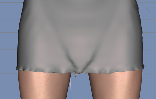

  • kyoto kidkyoto kid Posts: 42,407
    ...been getting poor fits of V4 pants on G2F particularly in the crotch region and butt.
    In the crotch there tends to be pokethrough (no gens morphs applied to the figure) that even what adjustment morphs are available don't fix. In the butt area, the mesh tends to get a "crimp" between the glutes rather than than conforming correctly. I also sometimes get what appears to be a poly sticking out as well even without smoothing applied.
    Have V4 for G2F so not sure why this keeps occurring.

    For the crimp/hump in the hiney try selecting left/right thigh then smoothing the offending bit.......IIRC on the Y axis......you'll know when you get the right one :) Even when creating new sets for G2F sometimes the pants look pretty bad when thighs are bent sharply. For the crotch...try scaling the pelvis on the Y axis.
    edited October 2014
    ...this occurs even in the default "T" pose.
    I'll give your suggestion a try for the butt issue.
    The trouble with scaling the pelvic area is that it could unrealistically change the proportions of the character . I would think that applying smoothing and collision detection (with the figure as the target) should help, but it doesn't.
    Post edited by kyoto kid on
