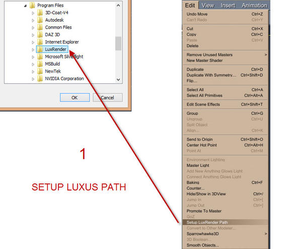

You will notice that Luxus demands to have its own folder and it wants to be pointed to it.
Once you set the path now you are ready to play.

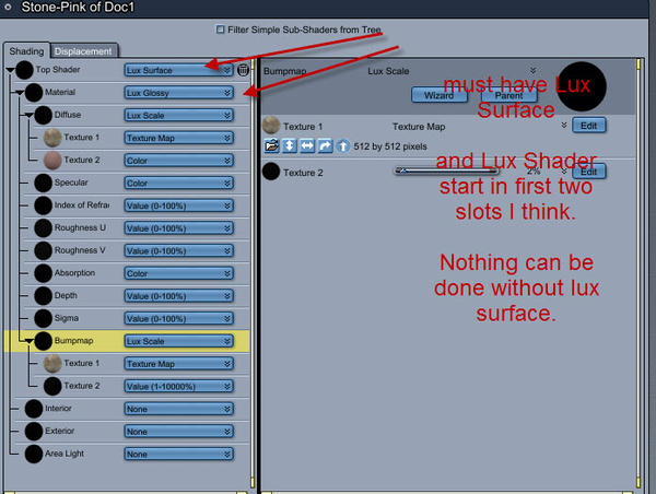

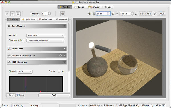

To set up the scene like the one in your pic , you need to look in presets I put mine in where I can find it, the shaders, the lights and the objects. The box you see in the image is from PhilW's objects and it appears to be some spots, although I'm not sure. It has two spheres, one with luxus glass shader and the other with some sort of marble.
Look at the shader tree and you'll see that the top level is very important and the second is almost as important to use Luxus only shader input. For instance, Bump appears to use Luxus scale.

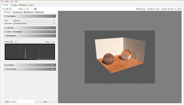

Now go to the render room and select "Lux Render for Luxus". don't worry about anything else. image 4
If you did it right , you will get the Luxus render in a popup that will look something like the one show here.

When you are ready to render you need to select the Luxus render in the Render room.
Luxus pops up as a separate render outside of Carrara when you hit the render button.

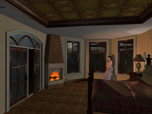

Can we get some Idea how to set up Luxus lighting, with or without Carrara's lighting, very confusing, I don't understand how to set it up or use....Here are the samples and the problems. One is done via reg Carrara render the othhye is LuxRender via Luxus. What am I doing wrong?
