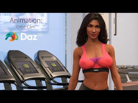

  • I think I found a video that kind of summarizes what you were saying -
    Thanks for the explanation!
