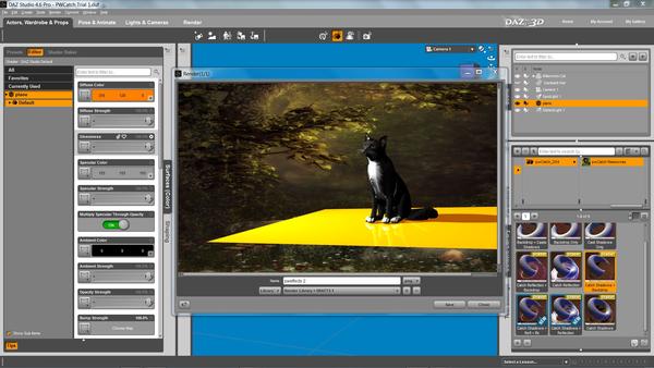

As you can tell, I am having trouble with PWCatch as a lot of folks seem to have had before. I have read the documentation, and just now downloaded and installed a fresh copy in case there had been an upgrade. I have tried everything that made sense according to the other forum posts on the subject. I am selecting both my plane and its surface, and using the camera to render. I am saving to PNG. I am using the latest DS 4.6 running on Windows 7 Pro 64 bit. I've been fiddling with various permutations of this all afternoon ^^;
The application of this shader seems simple enough in theory. The problem seems to be that the shader refuses to apply to my plane. If you look in the upper left corner of the surfaces tab on the picture below, you see it says 'DAZ Default Shader." I can't get it to say anything else regardless of which icons I click in PWCatch. It is changing the plane's diffuse color and is catching shadows and reflections, (the reflections even when I'm not asking for them!) but isn't the plane supposed to render transparent?
I would like to place my cat with shadows in this nice 2D background.
Anyone know why this shader will not apply correctly to my plane? ^^;
1920 x 1080 - 291K

    BTW the output PNG has no transparencies and does not show the background, just solid white except for the cat and the orange plane.

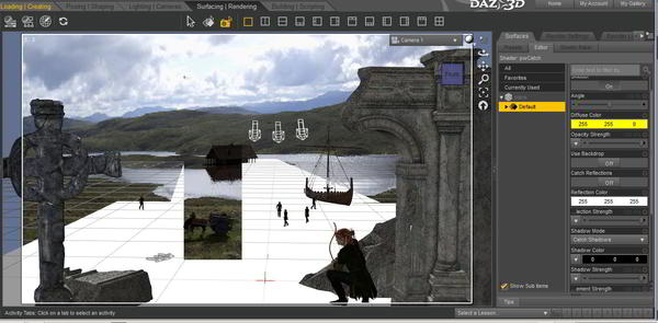

    I'm not sure why it isn't working. I used it on this image. There are two planes, one over the water using Shadow and Reflection and one using just Shadow. I have included the settings in case that helps.
    1360 x 669 - 165K
  • eponicaeponica Posts: 197
    Yes, thank you, that is helpful to see what the Surfaces parameters should look like. Mine are missing all those shadow tabs. The shader is definitely not applying to the surface.

    I am using the Content Library panel to find the shader presets. I have tried several times exactly as you describe and I am still getting the same problem.
    Interestingly, although I am clicking/dragging-dropping the Catch Shadow preset, the plane in the render is also catching reflections. ^^;
    Attached is the result of my latest attempt exactly following the steps in your description.
    1920 x 1080 - 283K

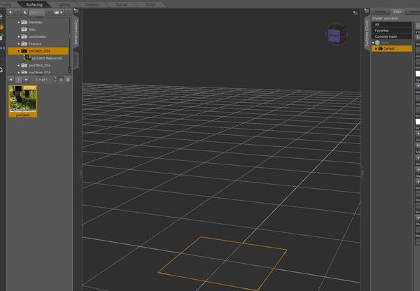

  • Richard HaseltineRichard Haseltine Posts: 112,089
    So you do this before you get to the stage of applying the shadows preset?
    1402 x 971 - 119K
    I believe what you're trying to set is a preset rather than the actual shader itself. In the root folder of the pwCatch in your content library is a basic 'pwCatch' shader. Apply that first and then add the preset over the top. Some shader presets don't contain the actual shader, but rather information for the shader to set specific parameters for you.
    Yes, Richard and Herald ^_^ I applied the PWCatch base shader first, just as illustrated by Richard. It is a single icon in the root folder. Then I go to the subfolder where there are several icons, and apply the Catch Shadows preset. It's a two step process ^_^ But the base shader, as illustrated above, is not applying to my surfaces.

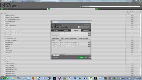

    OK... So now we turn to proper installation. Are these shaders hard coded to go in a specific location? Because I uninstalled and reinstalled them using the DIM with the same non results. At this point I better include a snapshot of my DIM settings ^^;
    I have two drives, C and F, with F being the one containing my libraries. However, F Used to be the C drive on my previous computer... This kind of fouled up the DIM so I have been installing most items manually.
    DIM settings :)
    1920 x 1080 - 215K

    There are two parts to shaders like pwCatch - there are the user files, the ones you see in the library, and they can go anywhere that other native content can go. There are also the actual shader files, and they have to be in certain places in the application folder. If DIM wasn't working, and you were using the DS4 version of the pwCatch installer, then it may be a good idea to check that in the Installation tab of the preferences your DAZ Studio application path iss et correctly.
    edited October 2014
    Yes, I will check that, thank you :)
    Edit: Sure enough it was set to F: instead of C: I just fixed it and used it to install PW Surface and it worked fine ^_^
