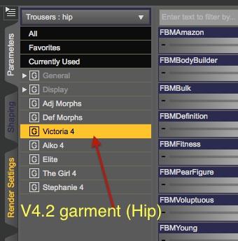

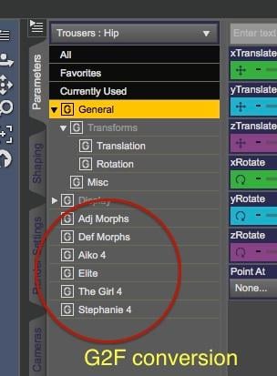

I'm a little uncertain how to describe this. I have (yesterday) bought the MallenLane product V4 for G2F and have had some success converting V4 clothing. Skirts have been a problem but that is being discussed elsewhere.
Another problem appears to be that the V4 adjustment morphs are lost in the conversion process. If I have G2F in the scene and autofit a V4 clothing item to her, it looks fine in the zero pose. But the moment I apply a pose to G2F (running, jumping, etc.) there is a lot of poke through. With V4 I could adjust the area of the clothing corresponding to the V4 body part to compensate. But I notice that all the V4 morphs parameter are lost when converting to G2F.

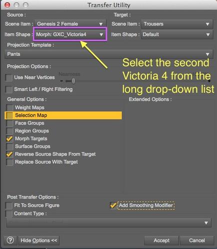

I seem to have stumbled upon the answer by trial and error.
I recently went through SickleYield's tutorial : Saving Gen 4 Custom Bones on Conversion and thought that might transfer the missing morphs.
Several tries and it did not but I decided to go against SY's advice and not select the V4 Clone. Instead, I selected Morph and then, from a really long drop-down list I found two Victoria 4 entries. I chose the second (click in the list and just keep hitting the "v" on your keyboard and it will cycle through all the words starting with V).
