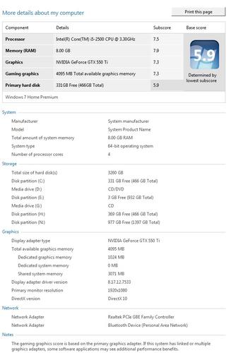

  • WendyLuvsCatzWendyLuvsCatz Posts: 41,664
    edited August 2012
    I have the cantankerous Hex!
    I do not doubt it is a hetter modeler than Carrara, it is just that, a dedicated modeler
    Carrara is many things with a modeling room thrown in.
    Richardchaos is a Hex modeler who uses Carrara for rigging and animation.
    he also uses a Mac
    on my PC at least Hex stops responding often, I can make umpteen attempts to softselect and move vertices and they will not move but then suddenly move several steps (laggy to say the least)
    I have a reasonably good computer
