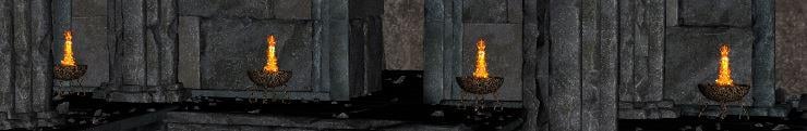

I created a brazier. I then created three instances of the brazier using the Create > New Node Instances. I had DS create the nodes as "Copy Selected Item." I unparented the instances then moved them where I needed. When done, I parented them back to the original item (and not the instance group). All is good so far.
I create a flame. Parented it to the original item (brazier) then found that there were now four of the flames. All in the same positions as the previously created instances.
Is anyone else seeing similar results?
Here is the Scene set up with the flame parented:
And the results on screen:
Now with the flame unparented and no other changes:
And the screen results:

  • That's normal. Any instanced item will auto instance any other item that is parented to it.

  • zombietaggerung said:
    Well, I'm not using 4.15 but I know for sure it does this in both 4.10 and 4.11, which I have installed.
    If this is true, then why don't the already instanced items that I parented to their origniator do this? Based on this logic they should recursively instance themselves out until the system crashes from a lack of memory.
    How does the new item, that is parented to the original item, suddenly adopt the positioning of the instances?
  • zombietaggerungzombietaggerung Posts: 3,969
    edited February 2021
    That I cannot explain, since DS has such wonderful and detailed documentation. But, I think it's because an instance isn't a full copy of an item, as in it's not really "real" as far as DS is concerned. So the original will duplicate anything parented to it, but an instance parented to an instance won't duplicate anything.
    Perhaps @Richard Haseltine can give a better answer.
    Post edited by zombietaggerung on
  • I find it hard to believe that that is the intended behavior.
    This means that once you instance something, you can never parent anything to it. So if I am sitting up a house scene and I want to use the same table in multiple places.. I can't parent the table contents to it, because they will be automatically replicated across all of the other instances, in exactly the same spots, regardless of whether that is wanted or not?
    I have never seen that behavior before and I have used instancing quite often.
    Yes, that's how it has always worked for me. And I don't know why you've never noticed this, all I can say is that this has been standard behavior in my experience (see screenshots in my above post).
