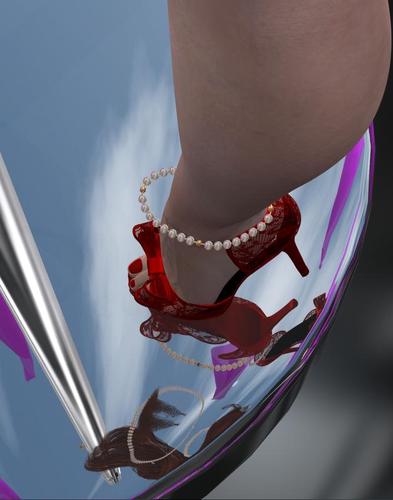

Hello, I am having a very odd problem with reflections ... it seems my girl wants to be a vampire against my wishes!

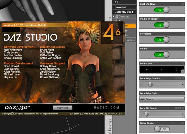

As can be seen in the attached screen caps, when I render the scene she does not reflect in the mirror surface, but her jewelry, shoes, and hair do! All the visibility settings are set correctly. The lights are standard spots and points. Her skin uses SSS, but her nails do not, and they don’t reflect in the mirror either. The mirror surface is standard, and I’ve used it without problems before. I’m not a novice, but I must be missing something simple which I hope will be obvious to someone! Thanks, JE

  • Richard HaseltineRichard Haseltine Posts: 112,089
    Select one of her skin surfaces with the Surface Selection Tool, then in the Surfaces pane check to see if the shader has a Raytrace setting, and if it does whether it is set to Off (which would hide the surface from reflections).

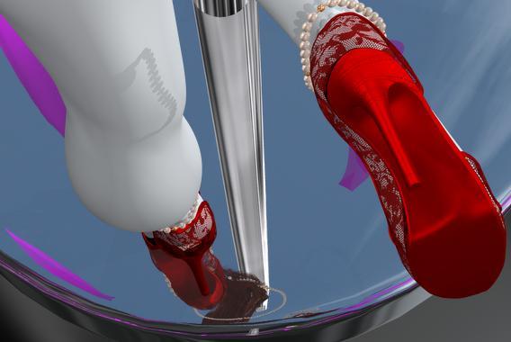

    I've tried setting those to the limit (16.0) and applying a non-SSS mat to the skin (after scrubbing all shaders), both to no avail.
    Freakiest thing I ever did see.
    There also seem to be no odd settings on the mirror surface, and the lights are all standard D|S spots and points, with nothing I can see that looks unusual.

    Even with the neutral grey shader, she is not reflecting, and I noticed she is also not casting shadows (but she does accept them!)
    As you see, the other items are doing both, so it can't be a problem with the mirror or the lights.

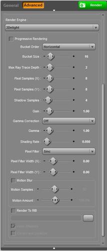

    I'm using low render settings for speed while testing, but the problem exists with them set higher.
