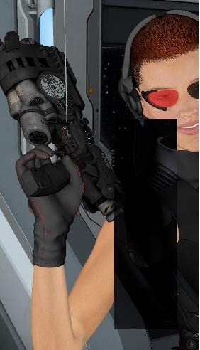

Okay now this is driving me insane (short drive I know, more of a walk really) but for some reason my model's skin will NOT render. I've googled it and maybe my search terms are wrong or I'm asking the wrong questions but geesh!!
So everything looks good until I render. Then the skin disappears. I've tried using different materials and messing with opacity, turning off subshaders.
With so many options I'm not sure. In the past I've used excessive profanity and restarted from scratch or just moved on. However, this is occurring more and more.
Below is an example. I am doing a spot render and as you can see Daz3d is really messing with my sanity.
Thank you!
282 x 492 - 41K

    Very unusual indeed. Can you select the figure and post the Parameters pane for us to look at? It might also help if you could give a screenshot of your Surfaces tab with an offending surface selected.

    Well, I know what the errors mean, but I'm not sure why they're occurring. The 'HSV parameters out of range' error indicates that 3Delight is having problems working out which colour certain polygons should be. (HSV being Hue, Saturation, and Value). But there doesn't seem to be anything which explains why it's having those issues.
    Time for some obvious questions. Firstly, are you using 32-bit or 64-bit Daz Studio? Secondly, What system specs are you rendering this on? Memory issues can cause all sorts of weird problems, so I wouldn't discount the idea of it making some objects invisible at render time.
