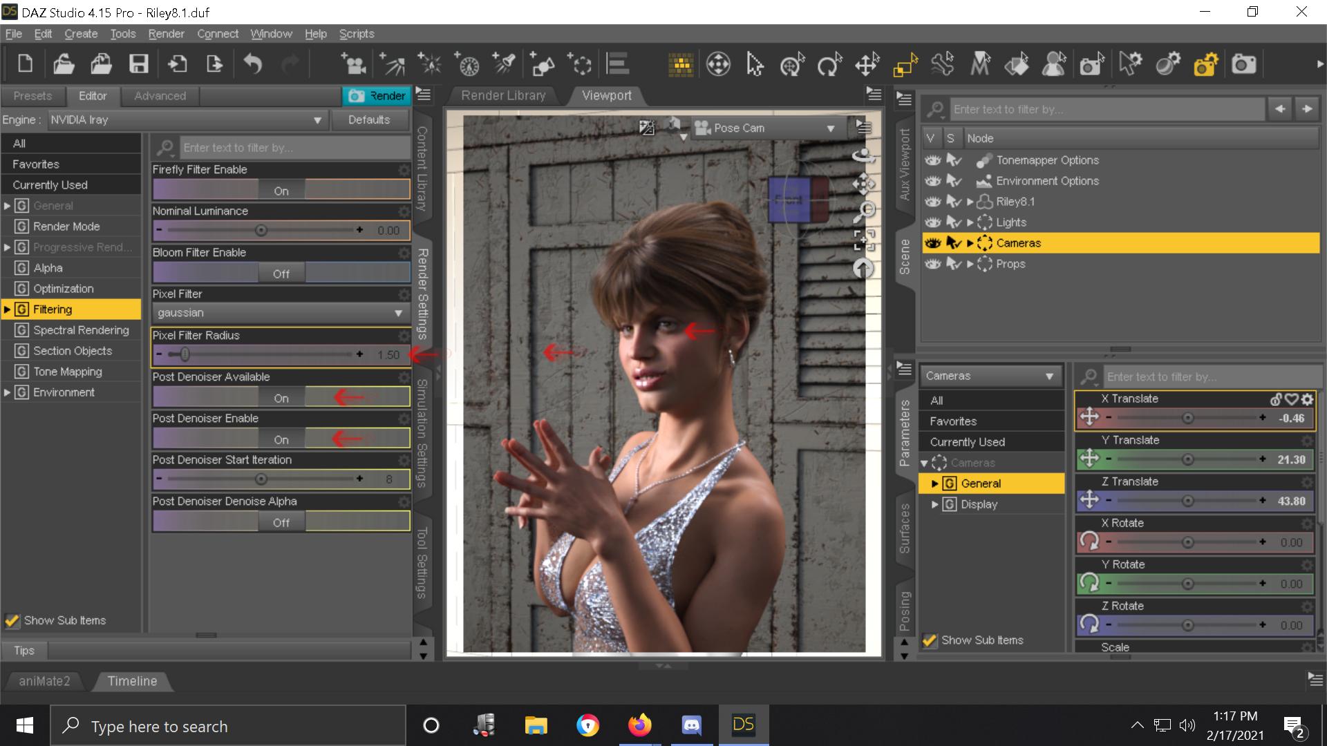

    Here are two images.
    The first one with the denoiser activated. The preview looks a bit blurry.
    Denoise on

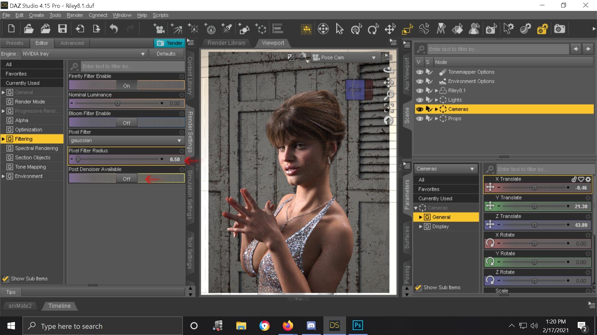

    The second one with the denoiser off. This preview looks crisper.
    Denoise off
    Note : with the Denoiser off, you need to render a bit longer, or more iterations for the noise to disappear.
