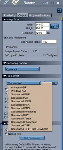

  • cdordonicdordoni Posts: 584
    edited October 2014
    I was not sure how to load them though.
    Usually the installer puts them where they need to go (in a system directory) so they can be used by any application. Then you should be able to choose the specific codec from within Carrara or a video editing application.
    In Carrara, if you go to the Render room, the File Format drop down shows the available codecs. You have to choose the "Movie" button to select the one you want to use.
    254 x 608 - 70K
    252 x 191 - 16K

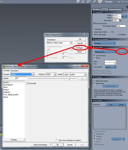

    edited October 2014
    I meant to say I finally saw ffdshow (I think) in the options window of the windows avi render settings.
    I tried installing FFMPEG and I must have remembered incorrectly. It only install the .dll and no configuration settings.
    Yes, you are right. FFDshow will let you use mp4 codec. It won't save the files with an MP4 extension, it just uses the AVI extension when it saves.
    I also installed the 3ivx codec for comparison, but there is no 64-bit version, so it does not show up as an option on my 64-bit system.

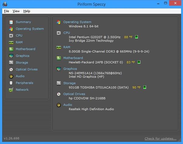

  • TimBoTimBo Posts: 151
    I'm hoping I have what you asked for. I sent a pic of my system. I am running Carrara 8.5 Pro (64 bit). My Carrara started doing some strange things after I messed around with codecs yesterday. Even my internet was doing strange things. I did a system restore and got it all stable again. So now I am back to having the default movie features of Carrara. I was just looking and I can't find where or how I came up with the ffdshow I had yesterday. I wish my luck was better about these things.
    1503 x 1188 - 183K

  • 0oseven0oseven Posts: 626
    I'm wondering if your system spec is the problem. It appears you are not running a separate graphics card and Carrara likes Nvidea based cards so just maybe when you render the avi in Carrara the output is not great and that would translate to any playback software
    I sometime get stutter when I playback in the render room but find if I run it 2/3 times it gets smoother however no problem with the saved file which by the way for quick reference I playback via the browser.
